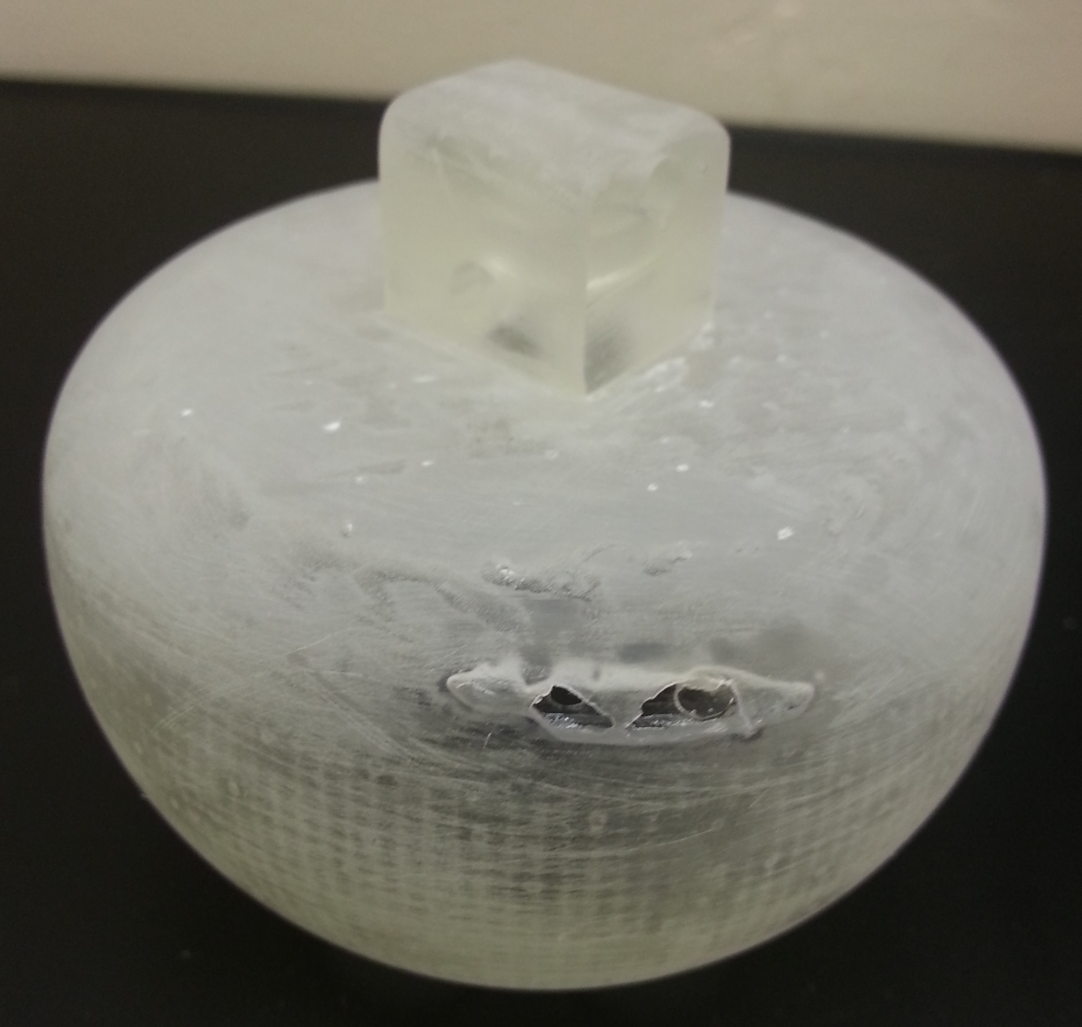

Hi,
I’m experiencing the problem you can see in pics 1 and 2. I’m using a pretty new formlab2 with clear resin version 2.
The printing file is showed in pics 3. Any suggestion?
Thanks

Enclosed parts like this work best when the open end prints first, so there isn’t a large enclosed volume of uncured resin. That should fix this issue.
What Ben said…
