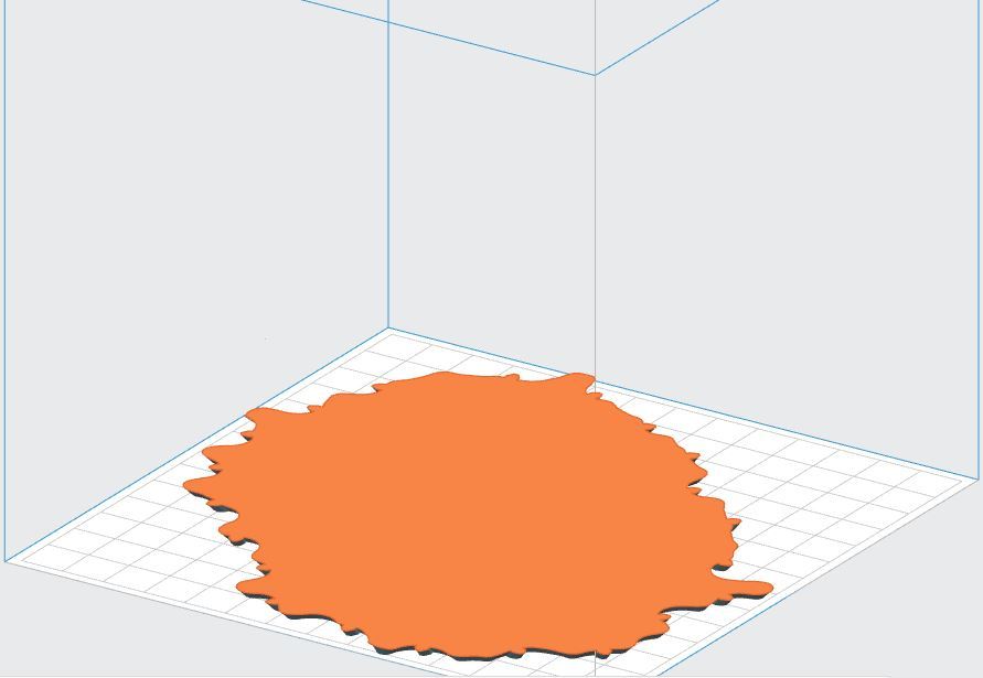

I’m printing an object that requires a large base, that almost completely covers the build platform. The knocking occurred on every layer for the first 20 layers. It stopped doing it on the 21st layer.
My guess is that the printer is having a little trouble breaking the print away from the bottom of the resin tank, due to the large amount of surface area of the base. Whether this behavior is by design or an indication of something wearing out remains to be seen…

I know the problem is being caused by the large base of my print. But the noise is not from the peeling, there’s no snapping of the bottom of the tank. The peel doesn’t work that way. The problem is occurring because the print is stuck. The printer tries to move the resin tank to the right but it can’t because the print is too-well adhered to the bottom of the resin tank and the build platform. It moves a little as strain builds up in the mechanics, though I can’t tell if it’s the build platform that’s wracking or the PDMS is getting stretched out, probably it’s a little of both. The noise occurs because the stepper motor drive that’s trying to move the tank “slips”. When it does, the strain that’s been built up is released and the resin tank snaps back to where it was prior to the peel starting. When it does this, it makes a loud “bang”. The printer continues to try to move the resin tank so the cycle repeats.
It’s clear the printer knows the resin tank isn’t moving because the cycle repeats for much longer than it takes to move the resin tank normally. I’d assume there’s a limit to how long it’ll keep trying, and that at some point if the peel can’t complete the printer will throw an error code and give up on the print. But in my case, after maybe an average of 4 cycles (maybe 15-20 seconds of trying) the print finally breaks free and then the resin tank moves smoothly and the build platform rises up normally.
