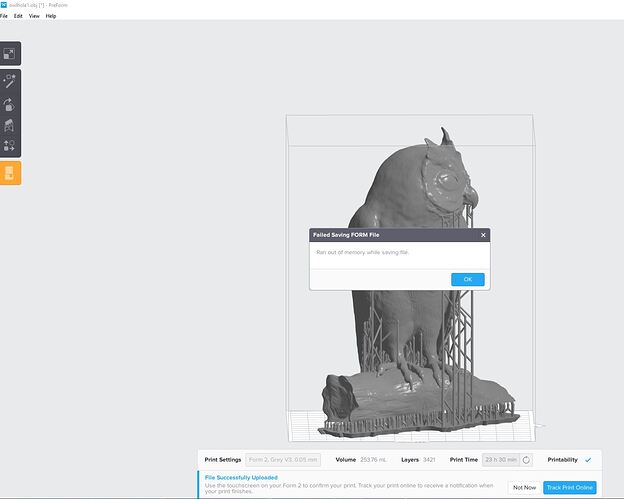

I am printing this large owl and the file size is quite large. I would like to save it for I am going to be printing number of them. I do get this error that it ran out of memory? My computer is quite large and I don’t believe my hardware is to blame. Is anyone aware of a memory limit. Seem that Preform should be able to handle this? I was able to send it to the printer without issue.
the owl file size is 430,334 kb

How much RAM does your computer have? Also, are you sure it’s not running out of hard drive space instead?
400MB is probably too much for that type of thing, you likely have too many polygons, it’s not super detailed so it’s probably something you could reduce the polygon count down.
