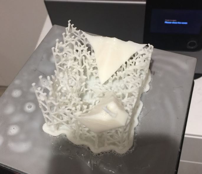

Our architecture firm has begun experiencing repeating issues with our FormLab2 printer. We’re attempting to print a small tower model but the print keeps failing for different reasons. Summary of our issue -
First print failures from a motor jam. Reset and started again, failure from a sensor issue when the build platform fused itself to the bottom tray.
Remodelled the model & updated all software and firmware to the latest versions. Print still failed, only printing the bottom corners with 80% of the model missing from the middle.
Could some please advise how we can resolve this issue? We’re based in Sydney Australia, is it possible to get a technician to come service the machine? We need models printed tomorrow so a quick response would be much appreciated.

The tray is brand new. We replaced it after the first lot of failures. The latest failure was the first print using it.
We’re orientating the model on a 45 degree angle with supports. We’ve noticed the platform doesn’t seem to be lifting out as much as it used too. On the early failures it seems the resin swiper may have been actually hitting the model because it hasn’t lifted out far enough. However the recent failures are more like a piece is just missing. See images.
Most of my failures have come from too much surface area in contact with the print surface (tray) if you could hollow your parts that might help. Besides that it will save you quire a bit of resin - that’s if it’s an option of course.
I would tend to agree. I’ve been printing parts with much more surface area per print than this and it prints fine. Haven’t been printing big parts in White though.
