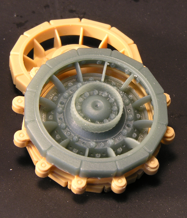

Here are the results. The Fender is 5 days after print… The grey would be in 10 pieces or more well before you reached a 10th of that… The part finally broke when the corners touched.
The other 2 photos are to show the detail I was looking for was still there which the Grey is superior for so in sense we now have the best of both worlds. The road wheels and Sprocket are 1 inch diameter (I have not printed at 25mic as I rarely do anyway as the difference in Quality is just not worth the time)
