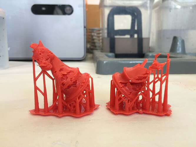

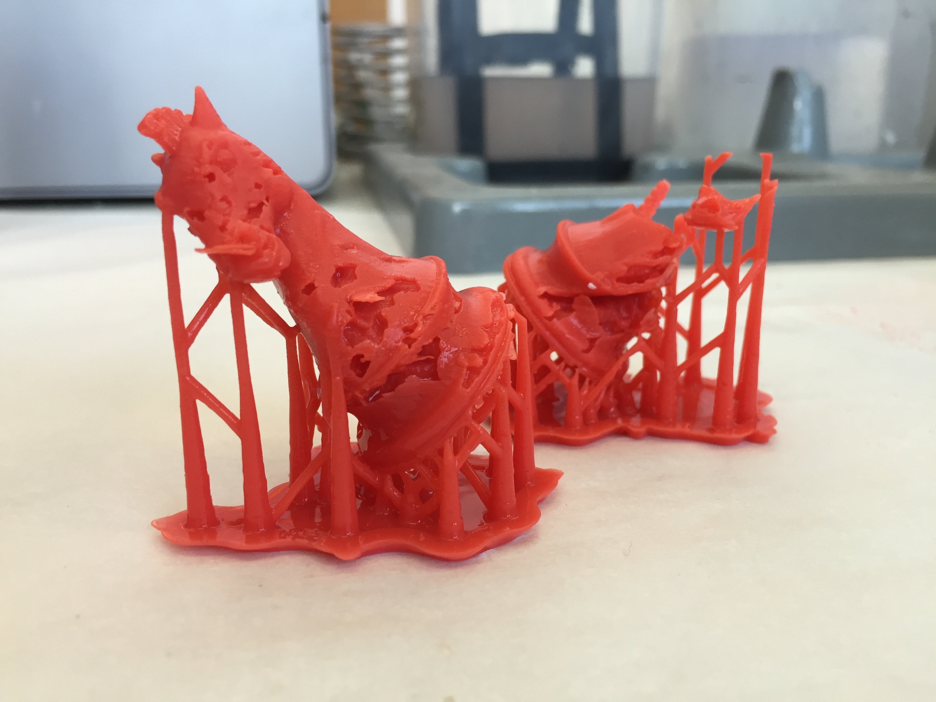

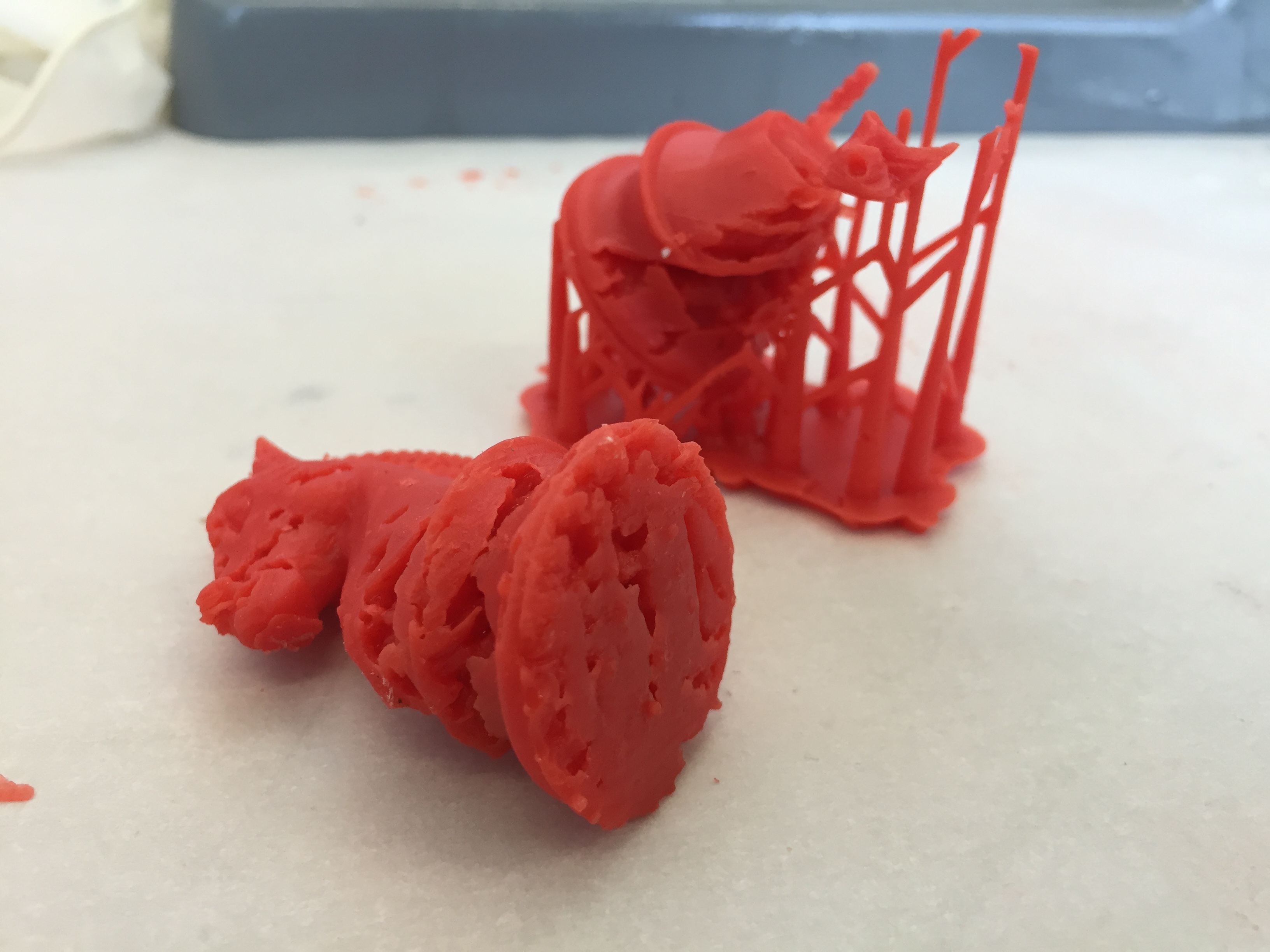

Lots of holes on the print
As you can see from the pictures. The right one was the first try. The bottom part looks fine but the side connected with the support has a lot of holes, and the print breaked in the middle. The seconded try also has lots of holes on it.
The model works fine on other kinds of 3d printer. The material is makerjuice SF.
Thanks.
Have you tried printing the same model in the same orientation with Formlabs resin? Have you had success with Makerjuice SF resin in the past?
You’re not using the correct settings for the resin, or the resin is NG. This does not appear to have the “hallmarks” of dirty optics, which can result in prints similar in look. But this isn’t that, near as I can say…
