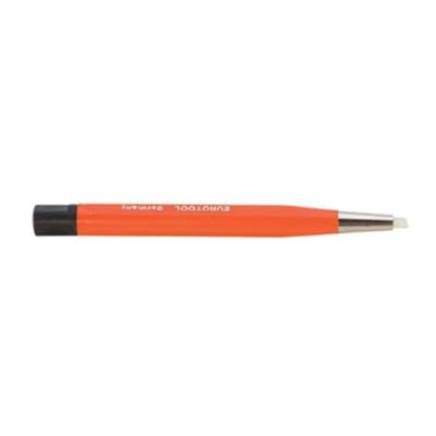

For finishing, I suggest you find a suitable scratch brush. I find the fiberglass kind most adequate. Like most abrasives, they range from coarse to fine. Mine is German built, and I got the impression that these tools are very often found in jewelers and model shops there. Here is an example:

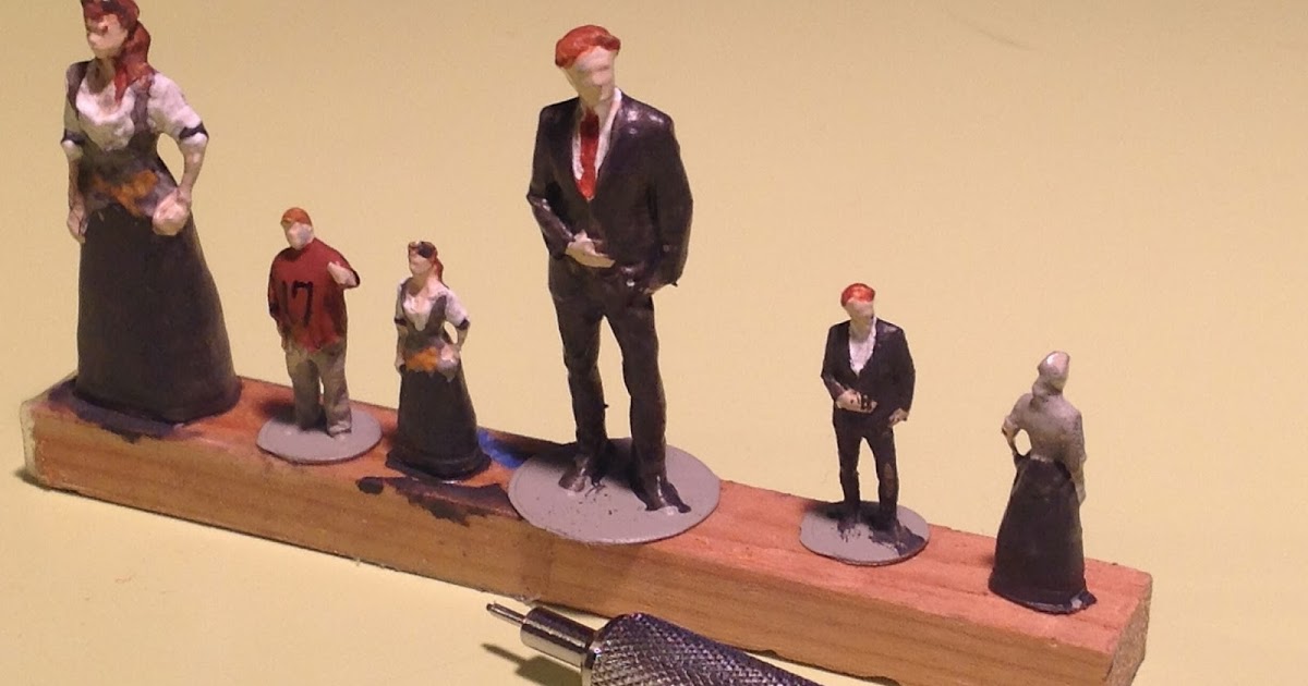

Any of the Formlabs printers should do fine for figures. I’ve used my Form One + for HO scale (1/87) and O scale figure (1/48) with fine results; 32mm ought to be right between those. Here’s early examples (with not great painting). These designs came from Thingiverse, often from the Great Fredini’s 3d scans of real people at NY Maker Faire.

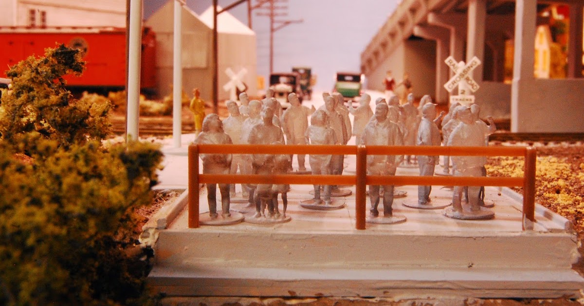

Here’s another example of 1/87 figures:
Either is best if you can print in bulk; printing 25 figures doesn’t take much longer than printing one figure; most of the time gets spent on the peel/wipe work on each layer.
