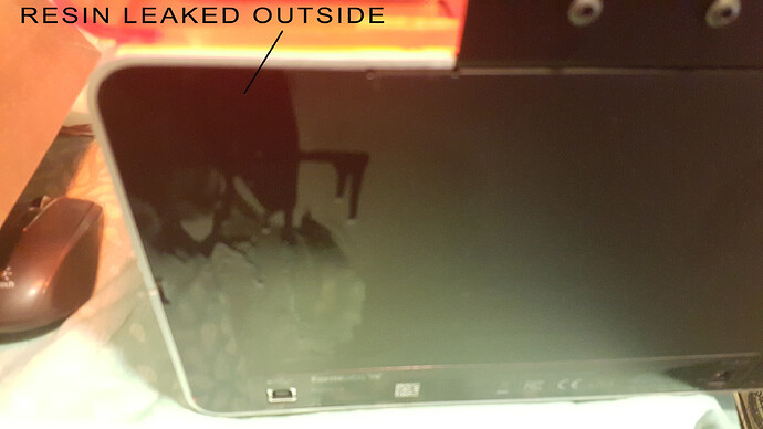

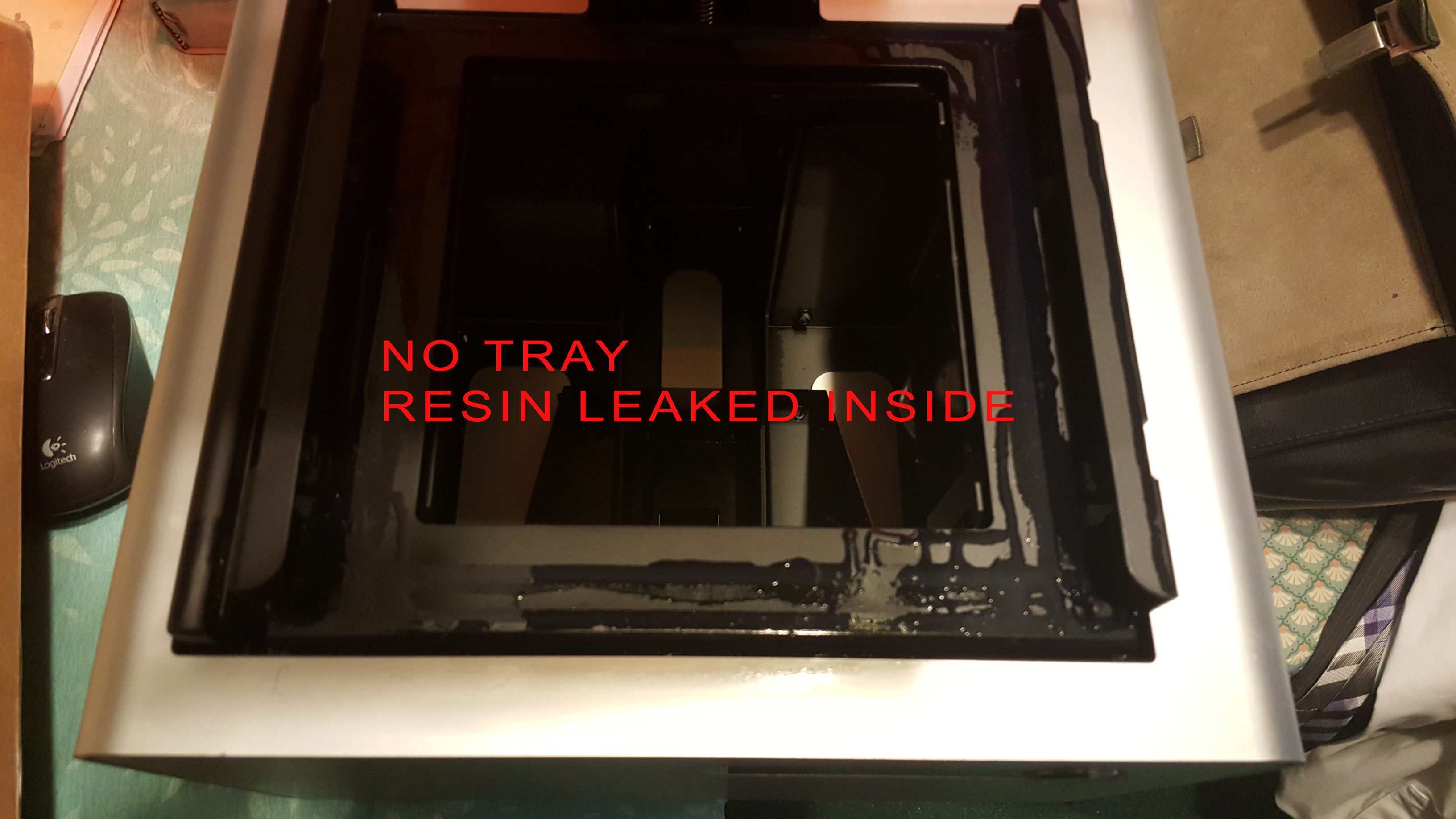

Greetings all, I just order a used FL 1+ and apparently the seller took the tray out and before shipping not knowing their was resin under it and closed the lid and stuck it in the box and shipped it. (I know just ask for a refund and send it back, I did that and we have worked out a deal to try and clean it up for a slashed price. I want to give it a try first.)
Are there any tips on what to do or not do in cleaning up? Here are a few pics
First I am confused on how there was resin in a tray while shipping and it got everywhere… but the only thing you can do is follow the cleaning instructions in the formlabs website unfortunately I would imagine that if it got on the main mirror that much that there is probably a good chance that you will need to clean all the mirrors to which you would need to put in a service ticket and wait for the instructions directly from form labs. What I can tell you is that you will need IPA 70-90% and PEC PADS
(DO NOT USE ANYTHING OTHER THAN PEC PADS ON THE MIRRORS DURING CLEAN YOU MAY SCRATCH YOUR MIRROR)
If it were me I would ask for a full refund and return the machine back to the seller. If he or she got resin on the mirrors from shipping then they probably didn’t package it correctly and if that is true then you are in for a world of hurt if the smaller mirrors or if the laser got screwed up. Good luck if you try to clean it yourself it takes a lot of time and patients.
I agree completely with Thomas! Obviously the seller didn’t really think it through when shipping you the printer. That tells me that:
he/she has no common sense…
he/she has no idea how to properly ship this printer (which coul cause damages not visible to the naked eye (as Thomas mentions as well)). Note that the resin has leaked towards the back of the printer (where all the electronics are!
he/she probably doesn’t know how to properly operate (and maintain) the printer and might have damaged the internals.
Obviously, none of this has to be true, but if someone was ‘stupid’ enough to ship your printer causing these results, alarm bells start ringing. Considering the price you’ve probably paid for the printer, I’d ask for a full refund and buy a printer from someone who does know how to care for such a machine properly!

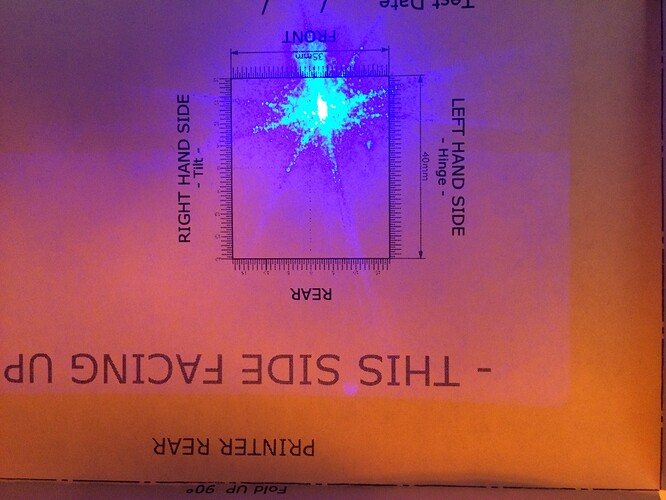

Thank you I have a ticket in now for an an additional problem being that the laser looks out of alignment in the diagnostic test. Hopefully this will all get sorted out so I can begin using it. We are on a deadline.
