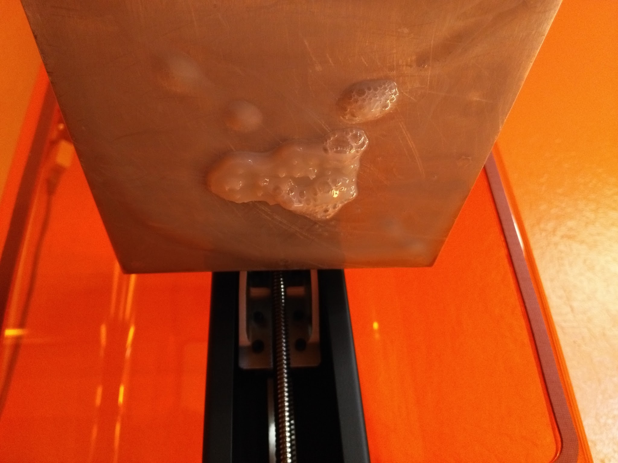

I’ve got one. I haven’t been able to get usable prints out of it at all, not even once - though I came pretty close the first time around with a new tank and new resin. After that first print (that was still unusable, very rough, and had a huge gouge in the side where it partially peeled-apart during printing), it was just failed prints over and over again. A base prints to the platform, while the rest just stays stuck to the tank. The Formlabs test print (butterflies) is always a murky, disgusting mess - though about half of the butterflies stick to the platform and could be considered “printed”, they’re totally ugly, nothing like what Preform displayed.
I’m curious if anyone has a Form 1 and can share some experiences with me, that I might benchmark my Form 1’s performance against others. I actually can’t find any information or experiences with the Form 1 (non-Plus) that I can compare against.
Formlabs Support already tried helping me through various cleaning steps - cleaning the galvo mirrors, replacing the tank and resin (I originally got it with 2-year-old expired clear resin, and its original Rev1 clear tank), but those changes only made a slight improvement. Ultimately, the thread ended with an offer to send in the Form 1 and get it upgraded to a Form 1+ at a fairly unpalatable price tag… and it’s not speed I’m concerned with, it’s basic functionality! (I can live with slow prints… indeed I wish the Form 1’s laser could move slower in order to actually cure the resin properly and perform a successful print!)

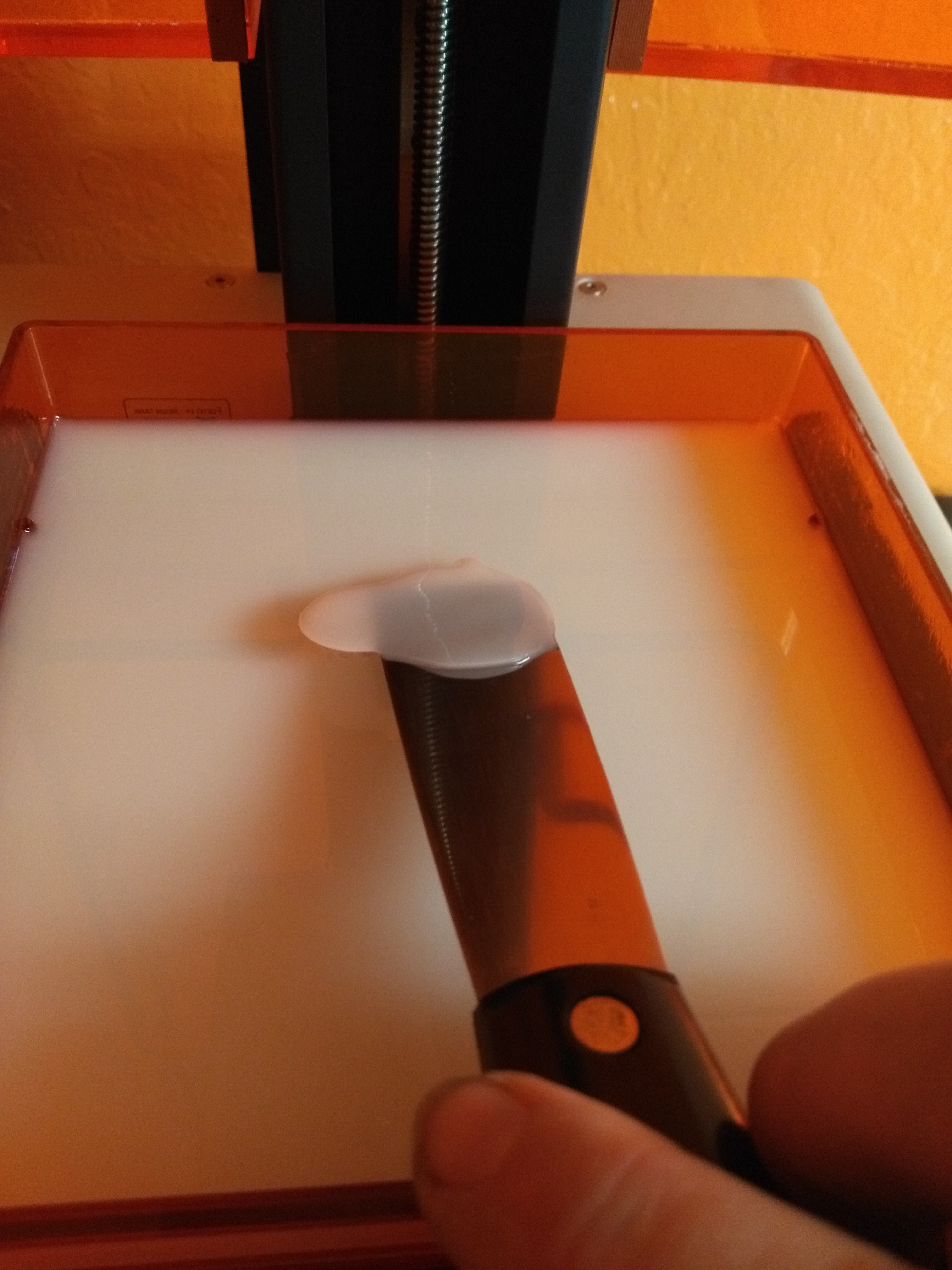

Lastly, I wanted to mention a clue I feel might be relevant. Most of the fails involve print segments not sticking to the printed base at all – the base always prints. In the previous successful print, the supports all seem to have stuck properly to the base, but the model had a big gouge in the side where it seems peeling went wrong - along with an overall extremely rough, almost random-noise, surface finish. Maybe the peel action is bugged somehow?

I tried setting the bed offset to -0.5mm (higher), just a few clicks down from center, because the base always adheres but seems thinner than specified. Current print is running at 0.05mm.
Any experiences in what resolution setting might produce more usable prints?
update: yep, another fine f*@#ing complete and total failure…
Same as I’ve ever gotten. Except the very first time with the brand new tank and new resin, I got that one mostly solid object. Every print since then has just gotten worse and worse like this…
update again: I just noticed this. This part I printed has the same edge profile from the point at which the part begins (bottom side) to the top, so it should have a clearly defined edge, from the gunk which was pulled out of the tank. Here, in the blob I removed, it’s a nondescript blob with only the vague shape of the intended part. Notice the full base printed and began printing the supports… so the only part that should follow should be the distinct outline of my part!
Maybe… maybe something about the laser or its targeting is so painfully coarse that it can’t follow a precision profile, and thus that’s why everything falls apart when small segments - like supports - are involved?

  1. your calibration has shifted. That is why your butterflies are printing off of the build platform. You need to send FL your printer to properly fix this.
  2. Your butterfly prints look like mine had on many occasions. It points me to a laser problem. Yes, many here will tell you that your mirrors are dirty. Clean them all your like. I highly doubt cleaning the mirrors will fix your problem. Again, FL is the only ones who can replace your laser.
