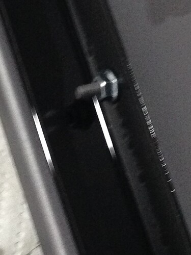

Anyway here are some pictures i took. The cartridge may have a bad valve as it keeps dripping out the bottom all the time.
It seems to me that Formlabs should take some responsibility for this failure and at minimum offer to do a factory cleaning without interruption of your warranty. This cartridge valve is an old design which is known to be problematic on other machines that are not 3d printers. I also suspect that these resin cartridges are supplied by a 3rd party supplier and Formlabs may need to work on quality control with that supplier.
