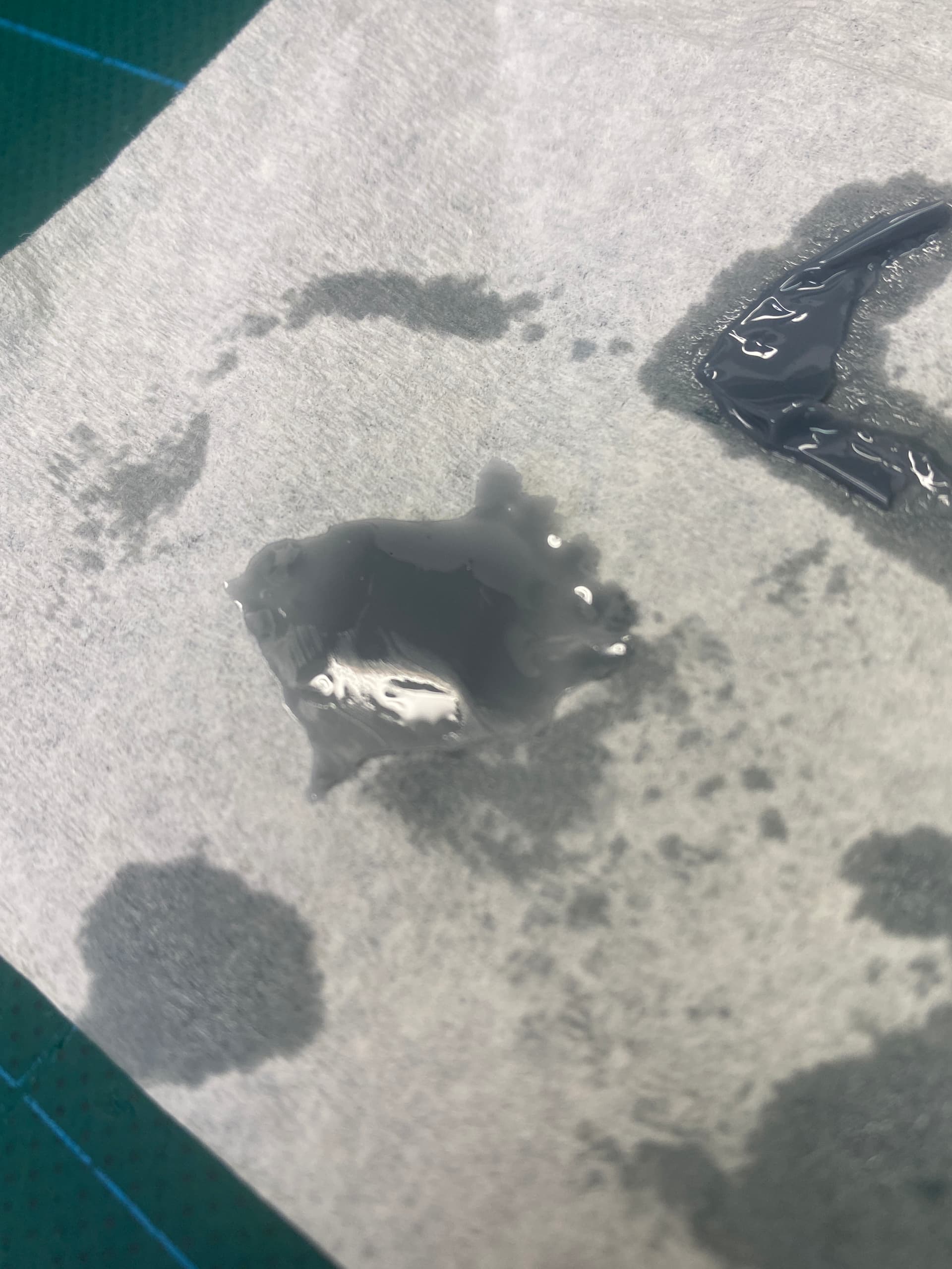

Form2 prints failing and weird halo around them
Have picked up an 2nd hand Form2 with not a lot of hours on it.
But printing on it has been a mare. Got one test print off it with a little cylinder, but am running this in Openmode with 3rd party resins and I’m getting nothing now.
This was a little box that had an open top about 15mm square. You can just see the square base at the centre with the halo of resin around the outside.
The prints have weird thin halo around the object being printed as if the laser is making a halo around the object, but I don’t think it’s the glass or laser. Have run it in the dark without the bed on and the laser appears to be working fine. Have cleaned the glass too, but it wasn’t very dusty at all.
Generally the objects don’t print in their entirety and they look all blurry and lumpy if they do print at all. Some don’t even stick to the bed.
What should I do to identify where the failure is?
