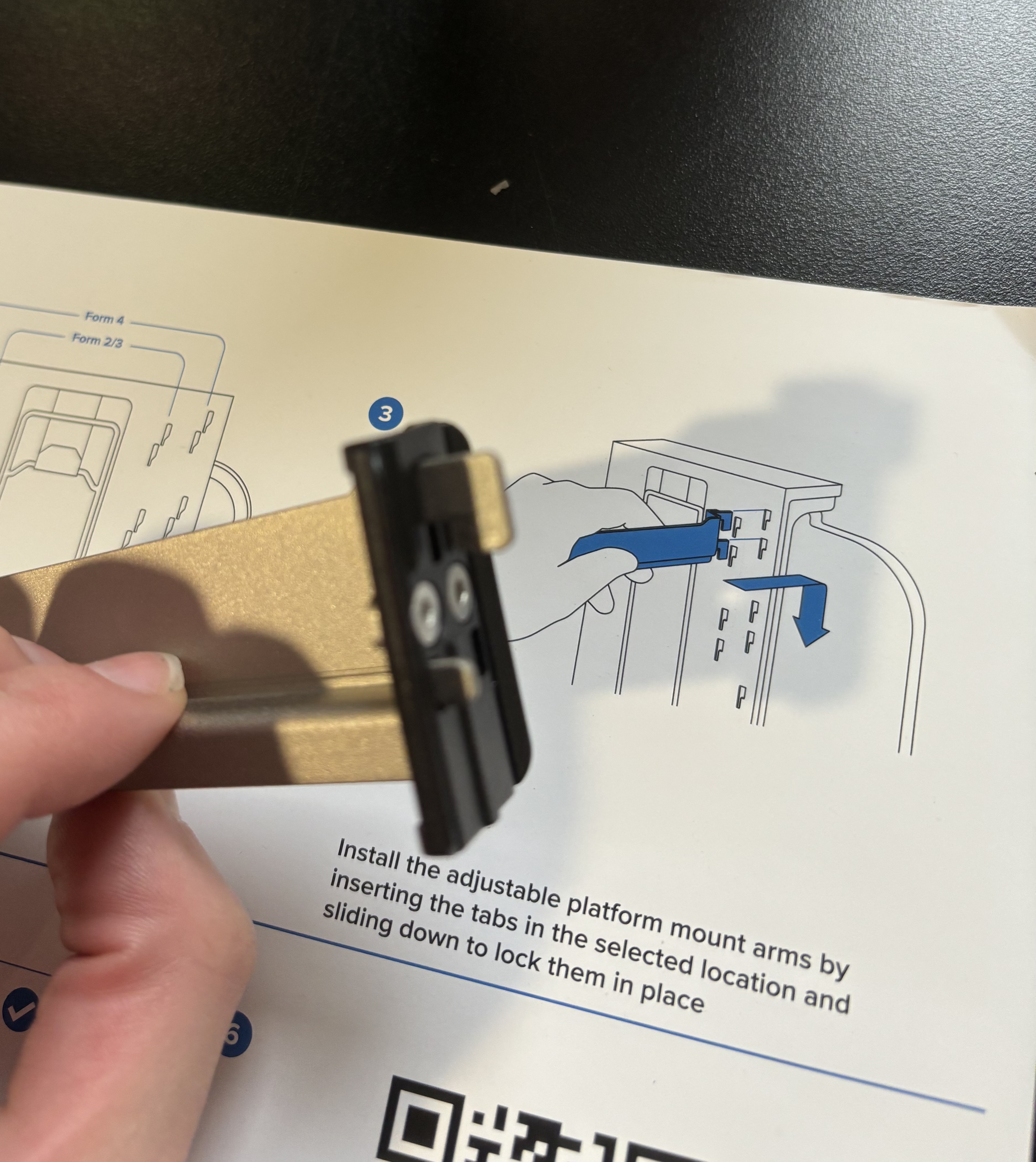

I’m having the same issue with the generation 2 Form Wash. It seems like the platform mounting arm tabs don’t match the slots they’re supposed to fit, and they’re different from what’s shown in the instruction image.
Hi @ThomasP please excuse our delay getting back to you! In the case you still haven’t found a solution - I believe you’re referring to the tendency for the forks to hit the inner lid during movement up or down? This is an issue that we saw few times in early versions of Wash Gen 2. You can probably fix it by gently bending the forks so they are angled slightly inwards. If not, please reach out to our Support Team and we’ll help fix this for you.
Hi @meghansurges , thanks for letting us know and sorry you’re having an issue. While similar outcome, this is actually a different issue than @ThomasP. The fork you have on that part require a bit of force to engage—you should press firmly towards the elevator plate and then down. When they are properly installed they should be very secure and not easily knocked out.
However, because of your post, we’ve noticed that the art in the steps does not match the product design! We’ve put in a request to our creative team to have that updated. Thanks for helping us improve!
