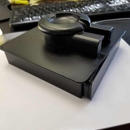

see photo I guess this is not de-lamination but the side pulling away
this is how it came out of the FW
the side piece is warped if i push in one side the other comes out
I had this issue on my brand new wash unit and brand new F2. I just pushed it back in and so far it hasn’t come out yet.

You have alcohol agitated and moving against a not fully sealed part that if it is glued, the glue is reacting to the intruding alcohol.
Design fault?
Why would you put the build platform in the wash?
Is it even designed to be in the wash?
Clearly it is a hollow part, and the IPA could leak into the interior. if it does… it might not all drain back out.
The same panel on mine came out a little… I could see it had a rubbery serrated fitment surface and was simply force fit into the injection molded remainder of the build platform. I pushed it back in.
If your’s warped, I would say it was from soaking in IPA…

I think the OP is using Form Wash Machine which requires the platform to be attached to the wash unit. This would mean most likely the platform gets washed as well. Also if not sealed correctly would allow IPA to enter the sealed unit resulting in failure of the bond.
I do the same, but I think the new Form wash is designed to take the whole platform, perhaps too much volume of print results in the IPA level reaching too high?
The platform is half submerged into the wash unit. It should be an easy fix, just push the panel back in and run a bead of silicone around it to seal it.

I could repair the new platform with silicone but I think a new platform should work without a DIY repair.

I have had this same issue with at least one platform that was never submerged in IPA. One side has warped out to have about 1/8 inch gap close to the metal surface. This was with the manual wash system where the platform never gets submerged but most of us will wash off excess resin from the surface and sides of platform with a rag soaked in IPA.
