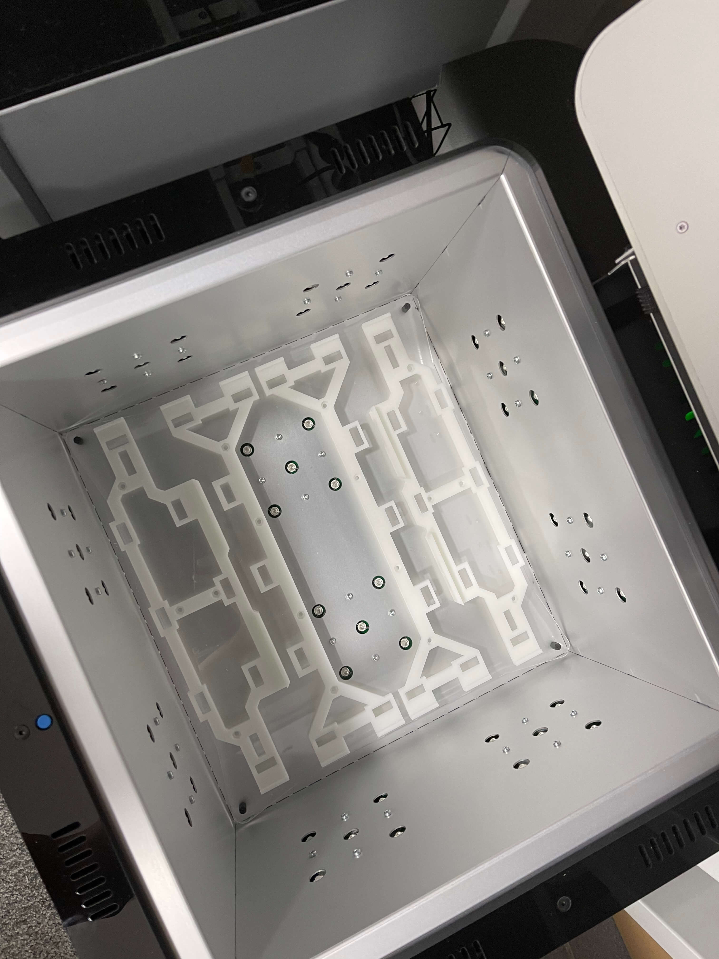

Our lucky streak with the printer has finally came to an end. After chugging through a bit over 2 liters of Rigid10K, we accidentally found out that the tank is definitely not in the right shape after a weird resin overfilled warning that showed while our print was finished and was being taken out. It seems our tank has decided its time for some fancy origami, although tank life (110/250 hours printed, 12/75 days with resin) is still at 44%…
Of course, this more than likely also got our parts compressed on one side, and I’m 100% sure the engineers did not draw it that way…
You are not to late and welcome!
I have almost the same side plastic issue in my Tough 2K resin tank, shown in your first picture. The magnet whipper took off 2 time when preparing resin. But I didn’t get fail prints. I hope that the resin tank will last is end of life… I wish you good luck too.

I’d reach out to support about that as i am sure you are already planning to. At least you should get a new tank for that!

Definitely will have a good chat with support about it. We’re pretty lucky to end up with a working machine, so once the tank issue is resolved we should hopefully go right back to printing.

Well, I do have a tank like that which has reached its EOL today but it sure gave me nothing but excellent prints so even a tank that looks like a roadkill isn’t exactly the reason for failures:
I’ll post the last print that came out of it before its EOL.

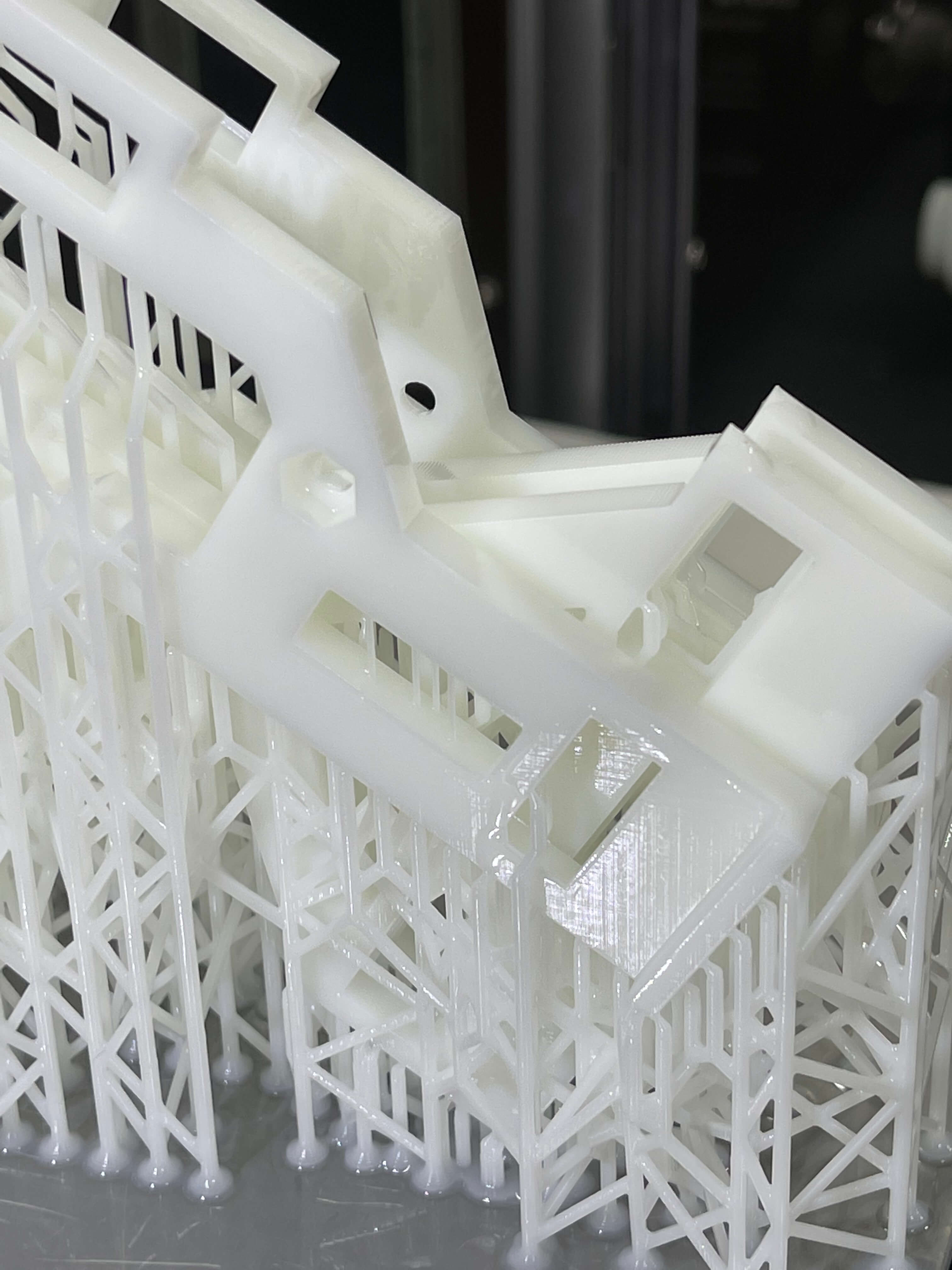

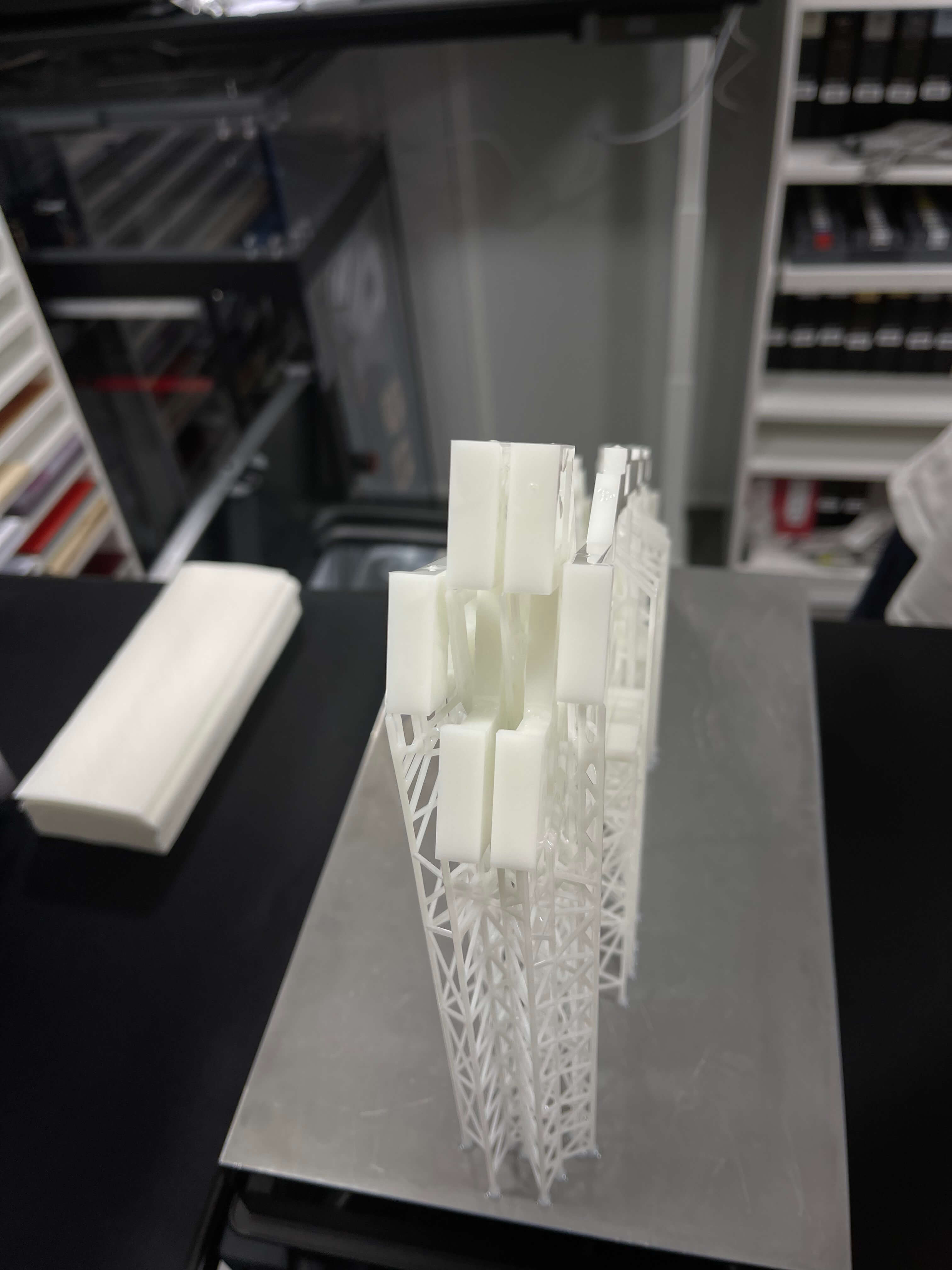

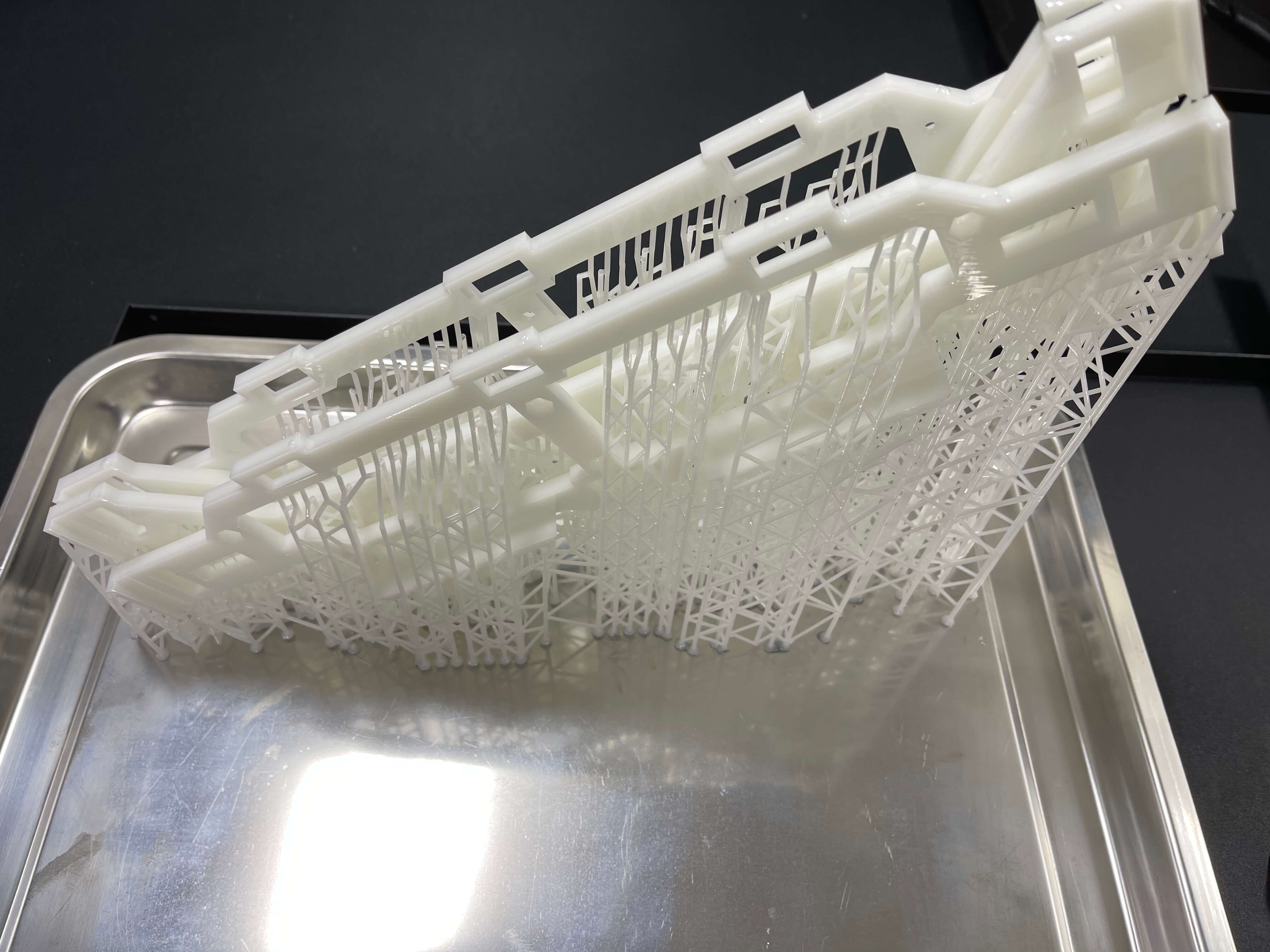

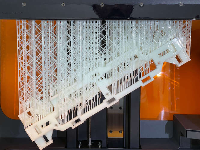

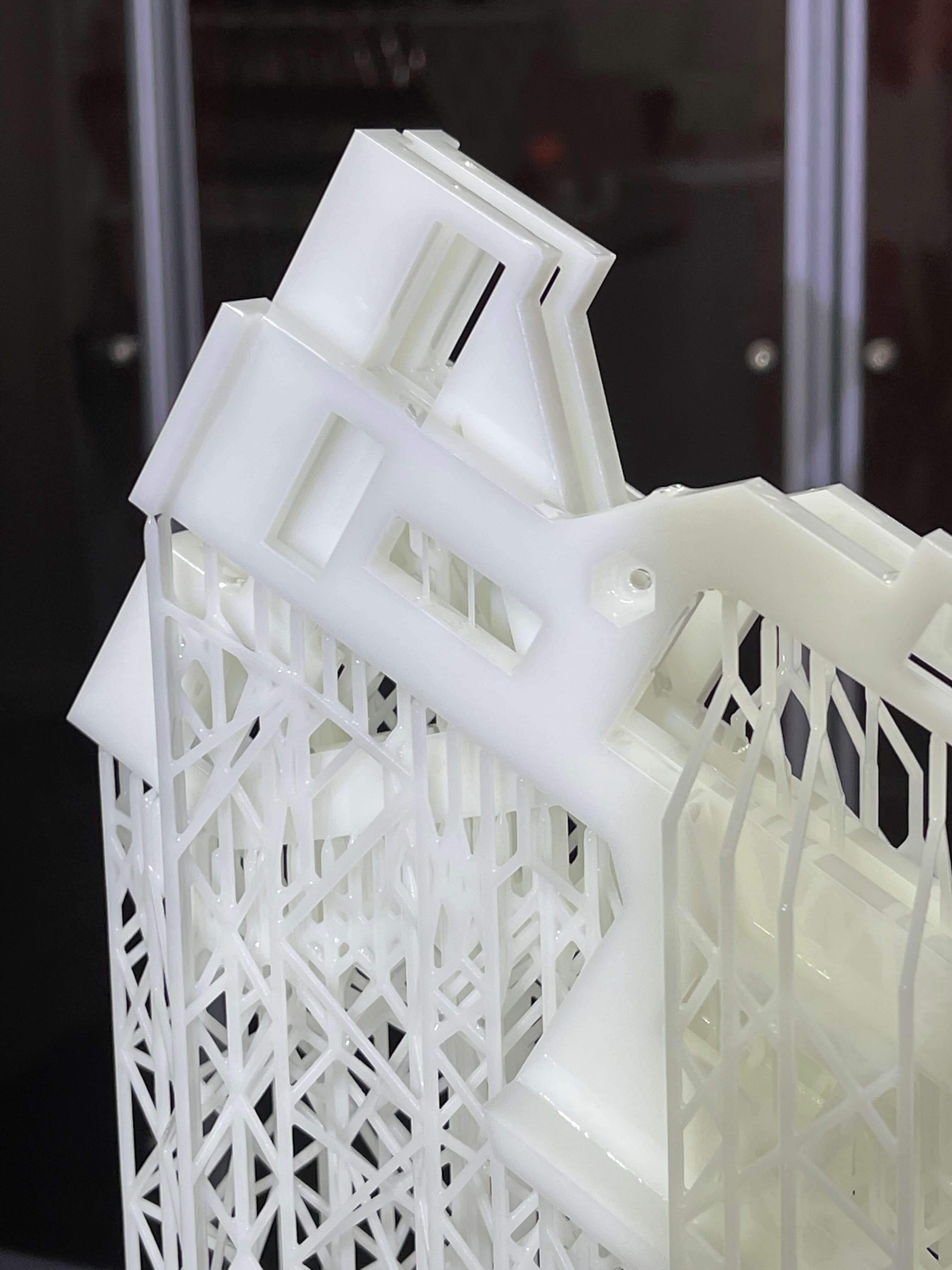

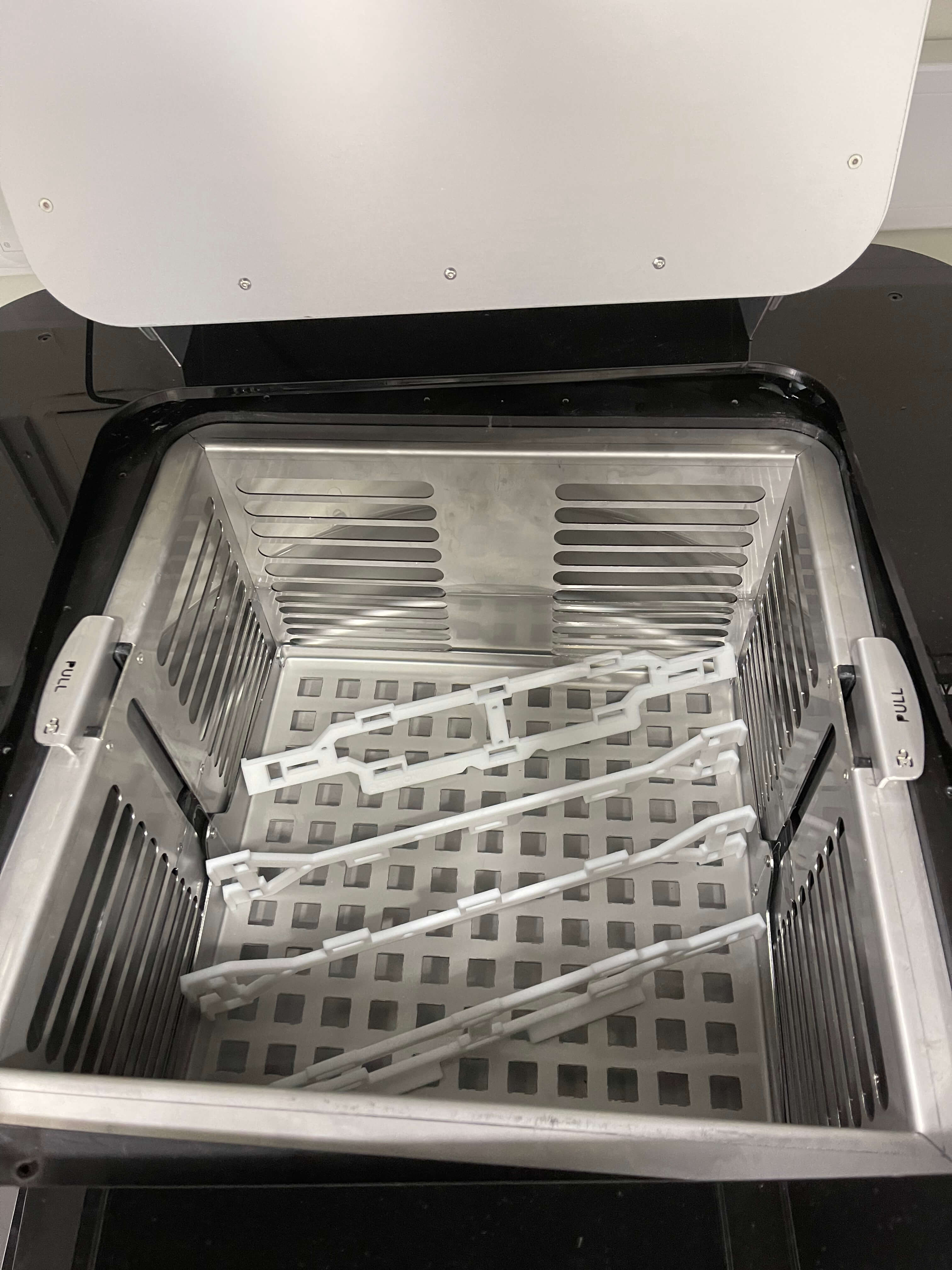

I finally got the patience and courage to do a 2547 layer print using Rigid 4000.
The print came out amazingly well. Excellent accuracy, no shifting, no bending.
Here’s a few photos so that you can see the whole and the details:
After removing it from the build platform (easy as always):
And regarding what was asked about the TPM / IPA cleaning process…
Bath with TPM in an Ultrasonic cleaner:
After the TPM bath:
The IPA bath to remove the TPM:
After letting the IPA dry:
Curing it:
The final cured parts:
And this was with the tank in my previous post. So, “bad” tank but excellent print. Go figure!
To this day I had zero issues with Rigid 4000 on the 3L and I’m on my 3rd tank (they only “last” 250 hours with this resin) and been through firmware revisions and Preform updates.
