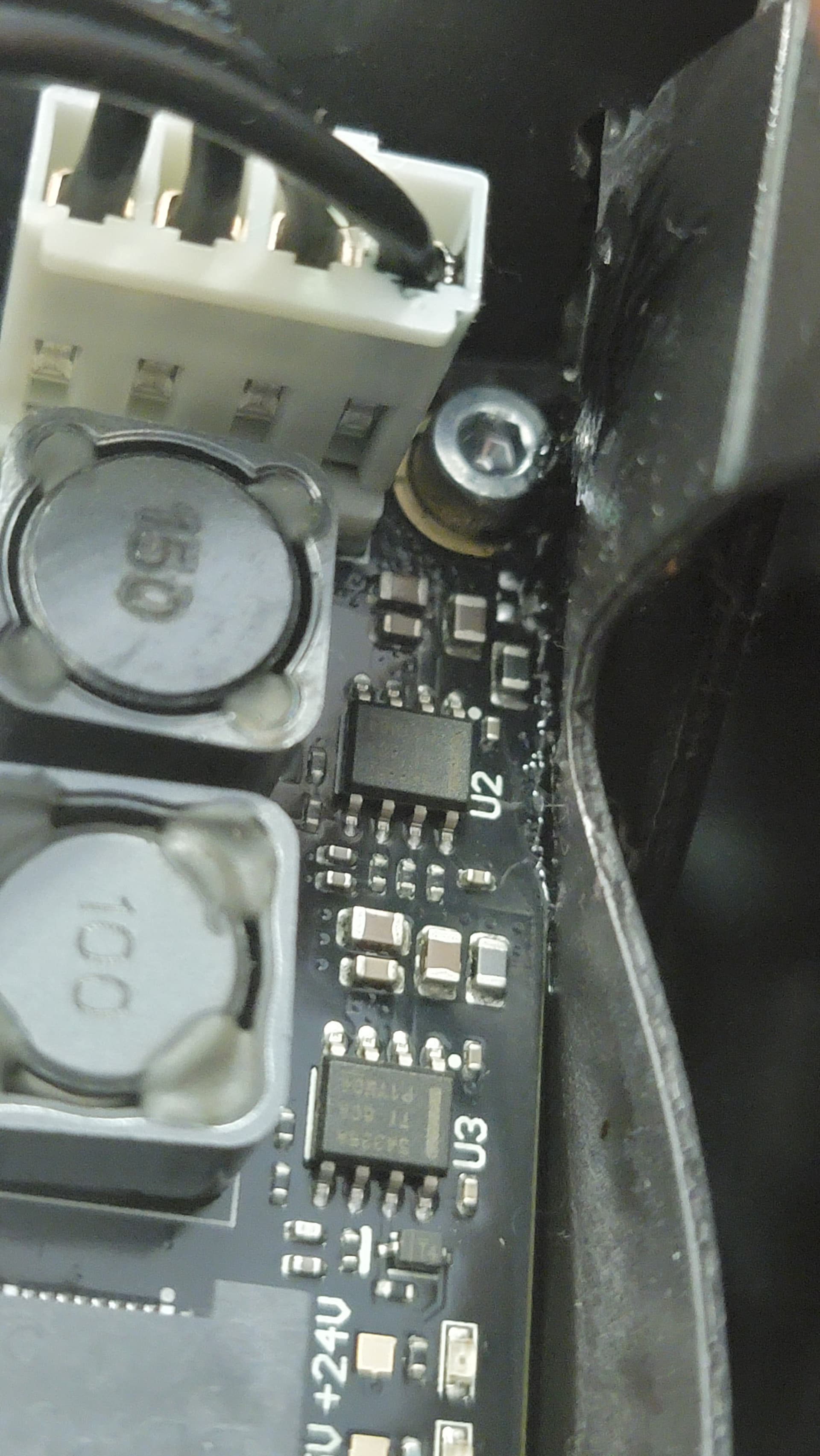

Well, I ripped the back off for shits and giggles since the thing is trash at this point, hoping to find a fuse or PS issue, and there doesn’t seem to be any fuse on the main board. There is a LED on the main board that is illuminating, so there’s power going somewhere. No fans or display though.
Interestingly, the case is poorly designed such that if you have a resin overflow from the cartridge dispense area, which I did at one time, the extra resin pools around the reset switch. I found the switch half immersed in black resin which may be the ESD resin. I’m half tempted to remove the reset switch from the board to see if it’s not in a terminally closed state. I tried cleaning it with isopropyl alcohol, but you can’t access the internals of the switch.
Are you able to test the switch in situ with an ohmmeter?
Yeah, grabbed a multimeter from maintenance and it seems to be working properly. There’s 4 tabs that go thru the board, 2 large for mounting purposes (grounded) and two others for “line”. When the switch is depressed, the two “line” ones are shorted, otherwise they’re open. Apparently I’m not that lucky as to have it be this obvious.
Resin has also traveled down the board, across some connectors.
Ok, well that can be eliminated then. Perhaps the resin is causing a short somewhere else. It might be worth laying the printer on its side in an attempt to drain some of the spilled resin. Another thing could be that although you’ve got an LED indicating that there’s power coming out of the supply it might be that the supply generates several voltages (5v & 12v for instance) and one of the other voltages is missing. It might be worth checking all of the PS outputs.
I’m probably going to have to rip the entire thing apart at this point if the resin overflow is the issue. Mind you, this spill was months ago, not recent at all.
The placement of the wiring with respect to the overflow trough is horrific. Excess resin (purple) will pour out the overflow trough directly onto the wiring below. That wiring (orange) has some plastic labeling that, in this case, collected the resin and allowed it to “pond” in that area. It then dripped off the lower edge of this plastic and onto the connectors on the right side of the board, contaminating all of them. Why isn’t there a tube for the resin to flow down? I suppose maybe you could be concerned about the resin blocking the tubing eventually? Better yet, have the overflow trough come out the back side of the machine!
