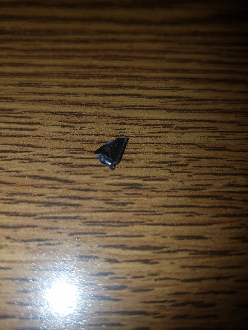

So I resolved the issue with the clicking coming from the Form 2.
Dan pointed it out the clinking was coming from, when the tray was sliding back in to center.
Not the best solution. Maybe I should have use super glue. But I ended up braking the corner.
The right back corner rubs up again a rubber guide or seal.
Thats funny the hole tray that moves side to side seem to be made from the same plastic the resin tray cover is made out off.
