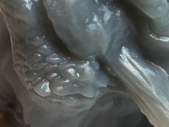

I show you a few tests done with my Form 2:
Large dragon head: size 40mm print layer: 0.05 mm gray resin printing time: 4 hours 30’
Small dragon head: size 20mm print layer: 0.025 mm gray resin printing time: 4 hours 50’
Post cures in UV oven: 30 ’
I must say that I am satisfied with the result, for a machine from less than than 4000 €
Some considerations:
  • hard resin and with very delicate details (small dragon head horns) is easy to damage the model when removing the supports.
  • if the resin was more matte, it would be possible to better highlight the details.
I show you some pictures

Thanks to everyone for the tips.
For these two tests, I tried to create the supports using the Pre Form default settings.
After I changed some settings: I changed the size, reduced the number of supports
and also the size of the contact points (0,40mm). The result is what you have seen.
I’m not complaining, rather they are very happy with the result achieved with a machine like the Form 2
(for work, I use professional 3d printers from about € 100,000).
Usually, I modify, create and optimize supports for my works.
While having reduced the contact points, with very delicate details and small parts
(wires, branches, spikes, horns, etc.) is easy to break the parts during the detachment of the supports
using the flush cutter, probably because the resin is rigid.
