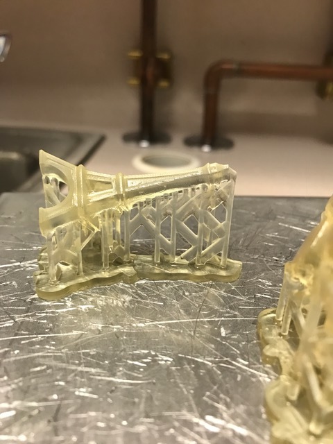

Bucktown Polymer mixed with FL Clear V2, approximately 30/70. Sorry for the poor support removal and post processing in general, these are just test pieces.

Ok boys, here are the results. I almost posted early and said ā€œI think we have a winnerā€, but I’m glad I didn’t.
  1. The parts printed successfully!
  2. It seems like one axis of the laser was off, or this particular resin has that laser ā€œscatterā€ that I have heard about. See the supports. In one axis of the print, the supports look perfect. In a different axis, the supports are all elongated (thickness). I am pretty perplexed by this actually.
  3. Even with the weird axis thing, maybe trying a different profile would reduce the ā€œscatterā€.
What do you guys think? What’s up with the thickness in only one direction?
PS Don’t mind the yellow tint, I think I had some of that Autodesk Yellow in the same tank at one point.
Ok a little more follow up.
Supports were a freaking chore to remove. It reminds me of when I generated supports in MeshMixer instead of Preform and then printed. It’s almost like the supports are part of the piece, if that makes sense. Also I was excited, so I wasn’t super careful. With patience I bet removing the supports would be ok, but I just like to rip them off :slight_smile: I will wait to hear what you guys have to say regarding the deformation of the supports, but at least it printed!
Can you post up some closer pictures of the support issues. I don’t think I can see them. The supports do look rather thick. I gather the resin is very reactive and is over-curing. I think you are referring to laser flare as it is usually off to one side or one axis depending on which printer of mine I am talking about.
I am sure my next question is up in the thread somewhere but… Which printer are you using and which resin profile did you use for this test? The bases of the supports look you are using a Form 2 unless you used the Tough V3 profile on a Form 1+.
