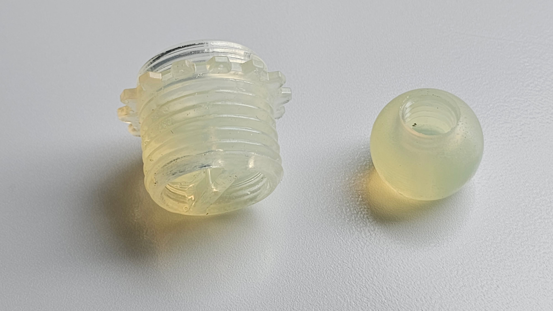

I’m seeing similar behavior (see photo) - which seems different than the images Durable resin parts shown in the online store. They appear to have very little tint.
Are my results typical? Are those store images of uncured parts?

This is exactly what I see as well, sometimes a little bit more yellowing (but this can also depend on how you take your picture).

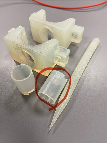

I face the same situation, the part that I highlighted is a little bit “clearer”, in this case I just cured the part for 10 min instead of 30 min, on the other hand this part is softer.
Just a quick note, thinner parts will appear less colored, same principles with shallow vs deep water. I’d say that circled part is pretty on par with the others.

Awesome point @henryqiu this make total sense. I’ll cure one of these thinner parts for 30 min to see the results. Thank you
