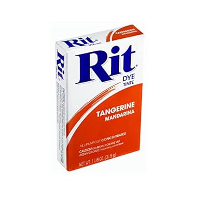

Has anyone played with RIT Dyes and Durable resin? Any comments on whether the powdered or liquid version works better? i.e:
vs.

I used the powdered version. I let the dye disperse into the resin. Very little mixing was done at first. Then I separated the colored resin and the remaining chunks of dye at the bottom. Then I mixed it all together.

I got ahold of both products today (powder and liquid). The powder didn’t dissolve completely (maybe given enough time it will). But in a quick and simple test print, the liquid linked above worked pretty well. Super easy to stir into a nice, homogeneous mixture. I mixed in about 10% dye by weight, with Clear V2. That turned out to be too much dye, and came out more orange and opaque than I wanted. But that’s ok, my main interest for this test was whether it would work at all. I printed using Black V2 settings (to bump the laser power up a little since the cocktail is much more opaque than Clear).
You can see the little dots of pigment in very thin walls (e.g. 1mm) but it’s fairly solid in thicker features (e.g. 3mm). The top surface is pretty tacky; I’m going to dunk in another alcohol bath and post-cure.
The powder and liquid on the left is from the powder dye; the part on the right in the foreground is printed from the liquid mix. The wall size steps from 0.5mm to 3mm.
When I used the powder, I think I let it dissolve for a week or so. Definitely not a quick process. I didn’t think the liquid would have worked so I didn’t try it. Looks like I should have. The dots in the thin part may be from the liquid as I didn’t see dots like that with the powdered flavor. But the powdered needs to have the chunks that didn’t dissolve removed.
Yeah, even the liquid seems to have little pigment specks in it (although it’s possible some of that got picked up from my previous use of the tank for the powdered mix). I expect something like UV Monomer Nano Pigment Dispersions would result in much cleaner tints (thanks @Kevin_Grisko).
My results did improve in both the powder and liquid mixtures by filtering. I used 226 micron paint filters, but I think a finer mesh would have been better still. My last test was with roughly 0.5% liquid dye concentration in Clear V2, printing under Clear V2 settings. If you trick the printer into thinking it’s stock resin, you can leverage the wiper and heater, which are really great for this kind of application (the dye prefers heated temperatures for better mixing, and the wiper helps keep the mixture homogeneous throughout the print) provided you monitor no splashing is occurring (at such low concentrations the dyes really don’t change the viscosity of the resin appreciably).
