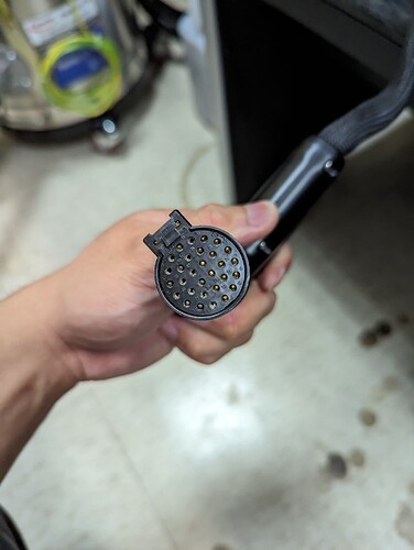

Hieveryone. I just got my fuse 1 and in my first practice i forgot to unplug the build chamber from sift before trying to pull it out to clean the top surface. So the build chamber connect is kind of broken.
I’m not sure if any pin is missing. But wonder if any know it could be a simple fix?
Nothing seems to be broken, but wonder if there any pointer that i can put it back in.
Hi @davince,
Thanks for getting in touch! Although the connector itself doesn’t appear to be damaged, the end of the plug seems to have gotten loose from the rest of the connector. I would recommend loosening the screws on the connector, pressing the end of the plug inwards, then re-tightening the screws.
