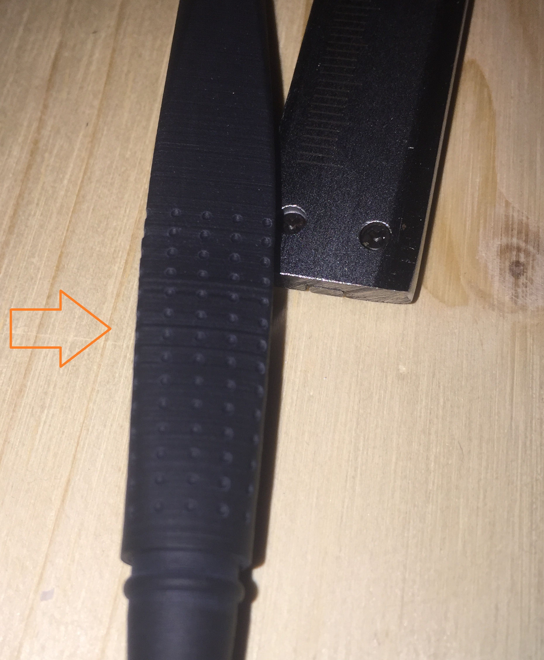

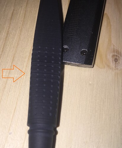

Thin, apparently Formlabs does not master worry about their own sample … embarassing on a machine of this range … the pens are printed completely vertically so without support, but there are ! still brands close to the pencil lead: /

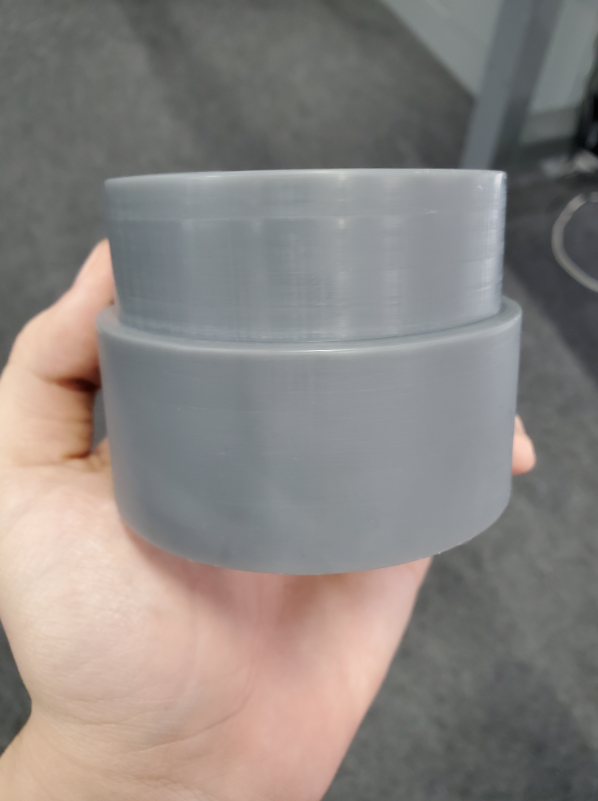

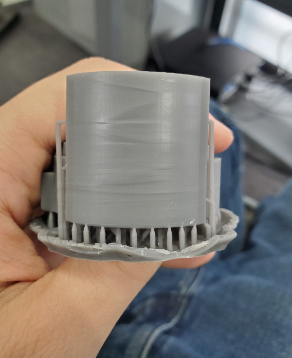

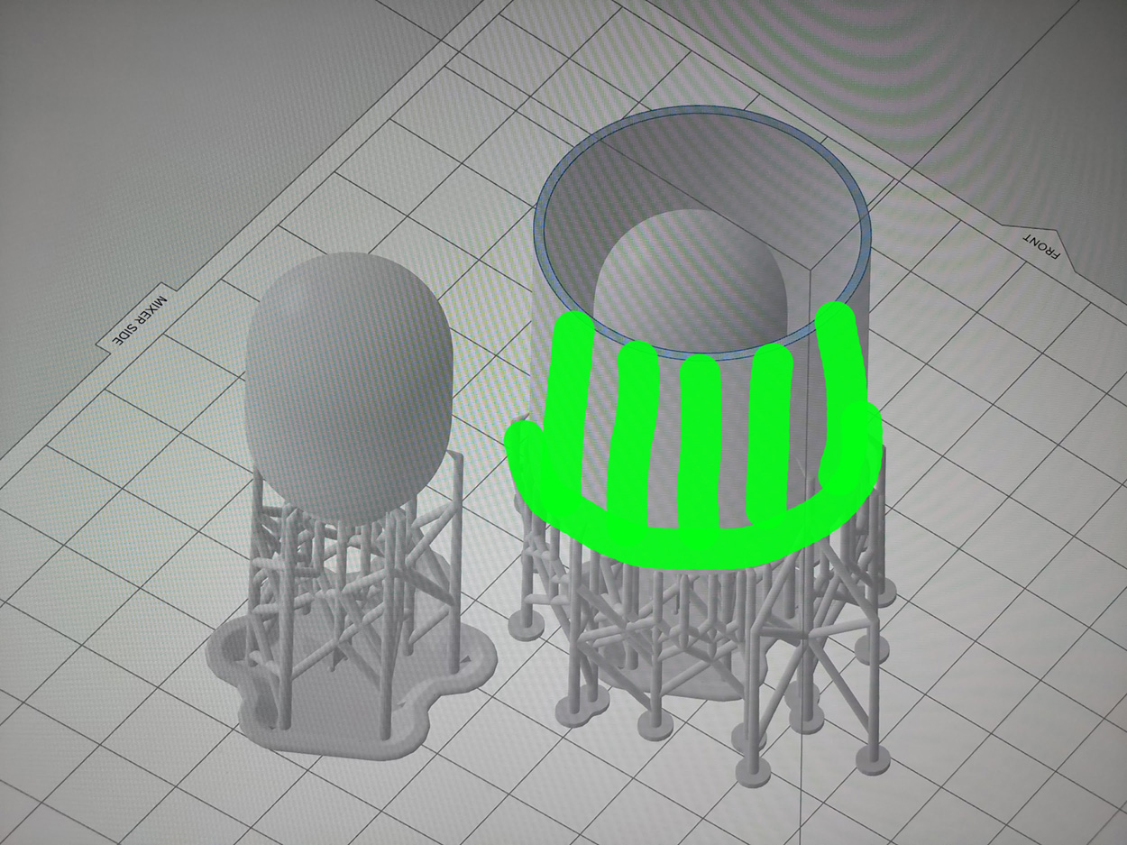

The image shows the difference on the same part between 100um and 50um on the latest firmware, along with a screen shot showing the orientation.
We’re seeing ‘crease lines’ on both but the 50um is much worse. The odd thing is that the angle of the 2 obvious lines on the 50um example are different, which is counter intuitive.

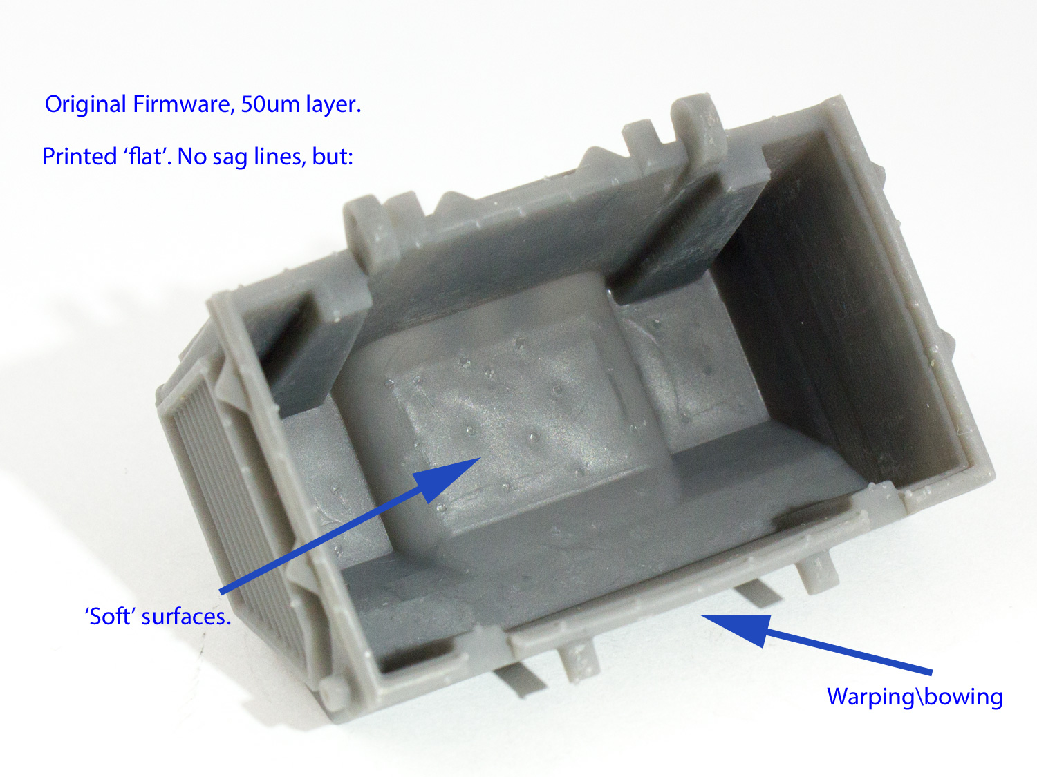

when the same part was printed ‘flat’ with the machines original firmware, the ‘crease lines’ are not present. However the part(s) warped quite badly and the inside face was ‘soft’ This with bigger 0.6mm touch points and default support structures.

Following on, the ‘flat’ part does demonstrate a crease line, but they are not as obvious as the other parts. Interestingly it’s toward the end of the build, rather than originating from a support point. I wonder in this case if it’s a geometry thing.
