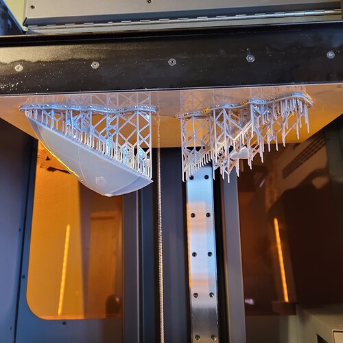

Well tried the new supports again only to have them fail. This is with a new tank as well. I had to stop the print since the one side broke completely away from the supports. Once side finished ok. I used defaults on everything and these are not heavy pieces. You know what’s really sad is my Form2 is still the most reliable. Every time I attempt a Form 3L print I end up with an issue.
