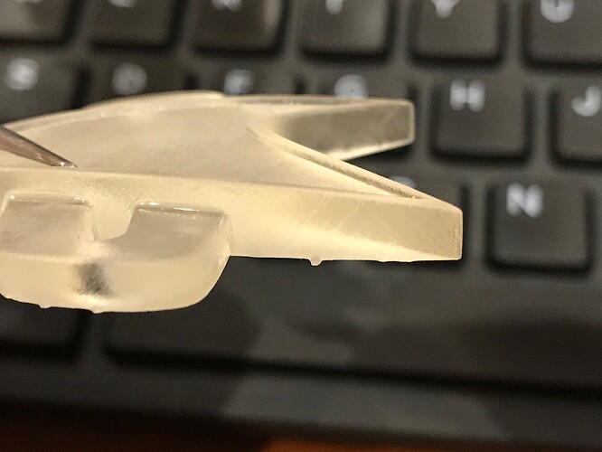

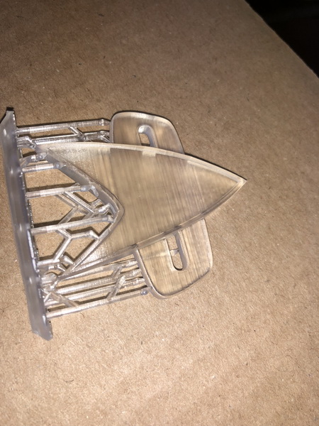

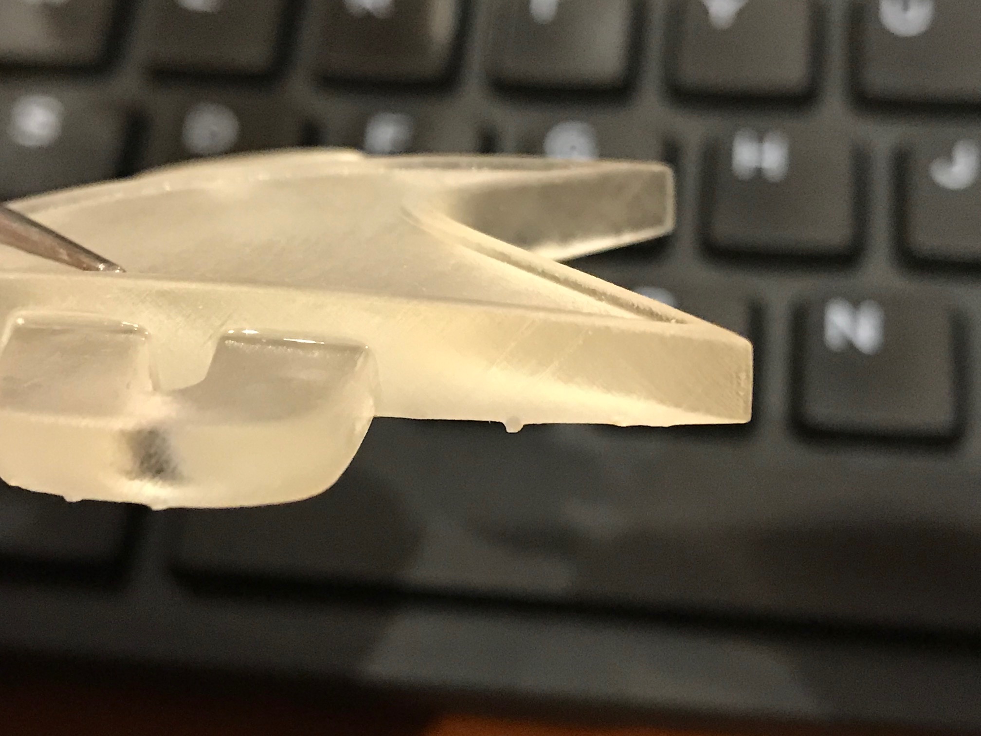

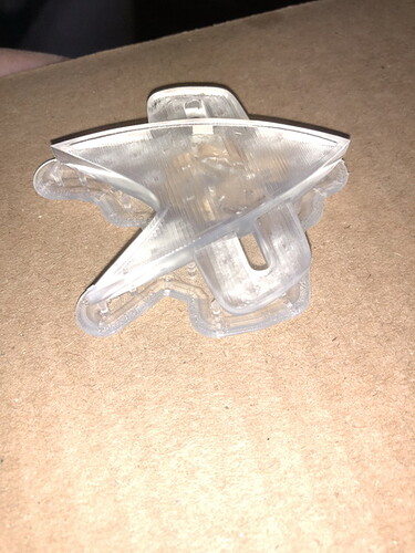

In friend of me and I printed the same, stl file…
i printed it laying with .5 .and standing in .25
both prints in the clean resin a bad, i see so many layer lines…
but the friend and also other prints of him or i see here are so smooth with no layer lines…
what do i wrong?
my photos

Looks like your friend printed at more of an angle, 30 - 60 degrees maybe. You will definitely see layer lines on a slightly curved part laying almost flat. The standing part may not have had enough support and wobbled a little and that is why you may have visible lines on the standing print. Try it at ~45 degrees.
Avoid planar surface that are perpendicular or parallel to the build platform. The closer it is to 45° the better, but it’s already much better than what you showed at 10-15°… it’s a matter of compromise between the number of supports and the visibility of the layer lines.
If you really want to be sure try automatic orientation. Cleaning will be much more difficult than your orientation but the faces should be much cleaner.
Shallow angles will show a high amount of stepping, you need to angle it up more to maximize the amount of Z-axis layers
Yes correct, you were right…
with the angel is a lot better and smoother…
by why? with fdm print i never used angels, because this were more bad then :frowning:

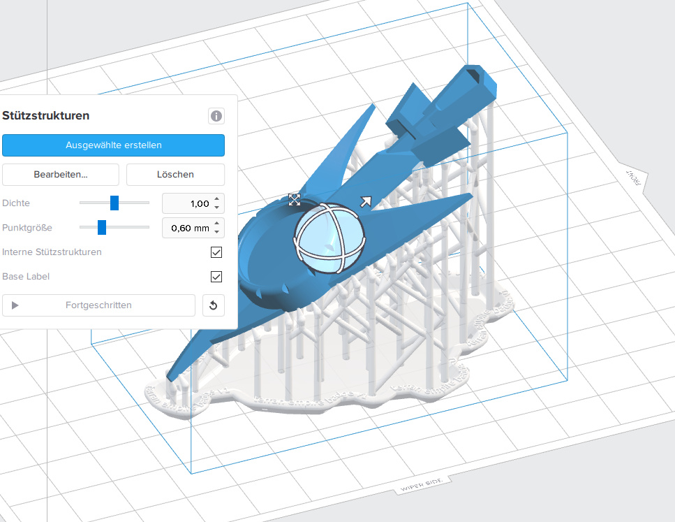

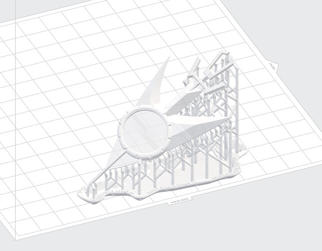

but the automatic mode want this
so on both sides an angle
and i thought this is best
but which is now betteR?
For best results you don’t want your supports close to detail areas and you want to make sure theyr’e in an area that is easy to sand smooth afterwards. Try to orient the parts so that details are facing more upwards. And also, it’s better to analyze the part yourself and figure out a good orientation, and then place the supports manually, you can get a better distribution of supports and avoid placing them on areas that you don’t want to ruin.
