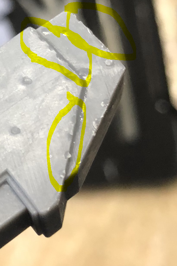

i m really really angry, i only want to print and make thinks, but as you can read in my other postings, i have a problem that my supports damage my sufface of my part. the material cracks away…

Can you post some photos? It is really hard to understand the issue without seeing some photo evidence. As for the support, they are great for what it is - free support. The cost of the printer is not that high if you compare it with similar SLA printers and NOT entry level FDM printers. If you want higher quality service with a phone support you would need to purchase their pro support plan unfortunately. While it is frustrating that it is extra $500 per year, I am happy this amount was not included in the printer price so I don’t have to pay it automatically.

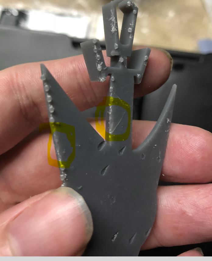

sure as you can see it here
i also tried different cutters all…
yes correct all, and because this dont work, i test it with different washing times, and also cleaning before cure and after that.
but the result is same, the support point damage the surface after cleaning and material spring away.
All non-powder-based 3D printing process requires some sort of support structure that damages the part to some degree where it touches. PreForm tries to pick good points that support the part. It tries to err on the side of adding more supports than necessary, since a failed prints are no good. That said, improving supports is something we are interested in.

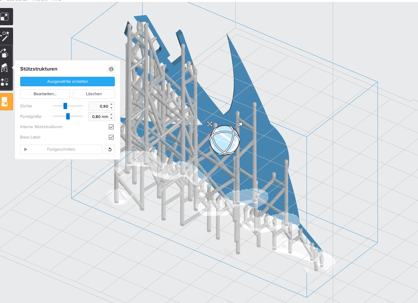

It’s hard to tell from that photo what’s going on. If you provide a screenshot from PreForm, people may be more able to help you get the result you are looking for.
Have you experimented with adjusting touch-tip size and part orientation?
You can to make the support points smaller. When the part has dried, don’t try to brake the supports off, cut it off the printed part leaving a bit of excess material. Then sand it off clean. This way you will get a perfect surface finish though it will take longer.
Also try relocating the supports or the part.
Consider making this part 2-piece which will allow you to locate the supports on the surfaces that will be hidden when the part is assembled.
If it is not confidential, it would be beneficial to share the fully supported Preform file ( .form) and I will take a look and see if I think supports are the issue. I will give you a new file if I think changes should be made. If the supports are correct, and you following the post-processing instructions that I gave (and FL recommends) then I don’t know what to do.

Definitely make the support point size smaller - 0.3 - 0.4 mm and move just a tiny bit away from the edge.

Your support thickness seems to be very big and support placement is far from optimal…

ok then take this as reference and show me please how you would print that
