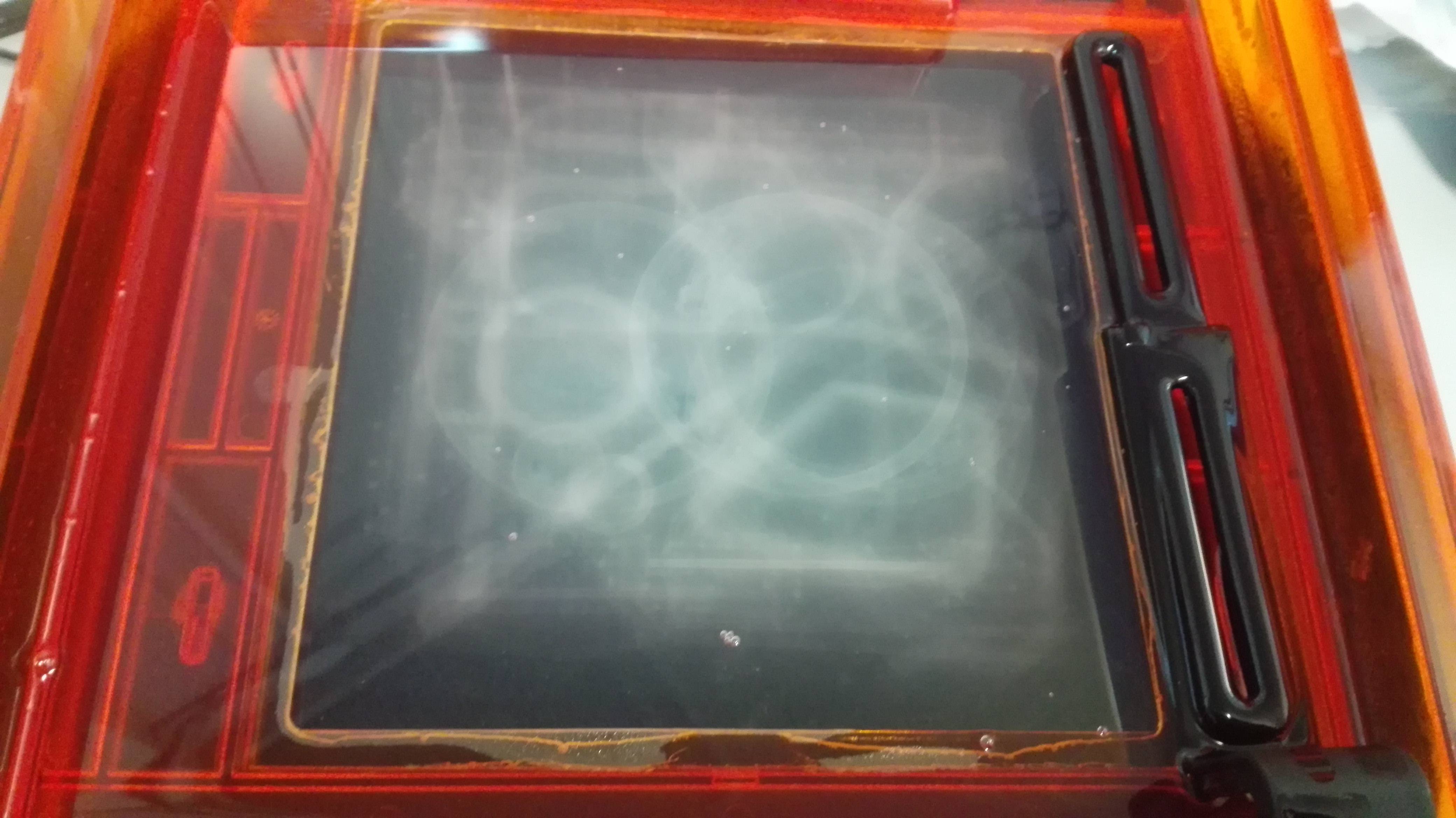

Here some pics of my HT resin tank running in a F2 machine.
It has been used for less than 2 cartridges, but it seems very opaque.
Since I still have no experience on this, what do you think about?
It’s a faulty pdms layer?
It’s normal?
I must say that a clear resin tank in use, that is now at the 3rd cartridge, is much less damaged than this one.
In my experience, clouding can be indicative of tank failure, but not always correlated. I have had super cloudy tanks (like the one that you have) that print just fine. And I have had not so cloudy prints after several liters of resin that require replacement. Generally, if you are getting good prints, no need to change the tank. For a tank that needs replacing, you should see print quality degradation before complete part failure.
As for high temp, I have only used it once before. But I believe it is one of the more aggressive resins: for the same print jobs, you would generally need to replace the tank more frequently than a standard resin like clear.
How is your print quality on this cloudy tank? Is it still OK?
I think that printing quality is going bad. I can appreciate the difference between the first and the latest prints.
Anyway I already planned to discard the tank at the end of the cartridge.

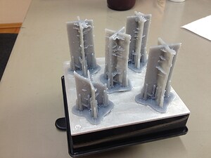

Here are some pictures (rashing, then ragging, then explosion):

Nice reply, my prints have started to be similar (even if much less) to the pic one (plack part).
