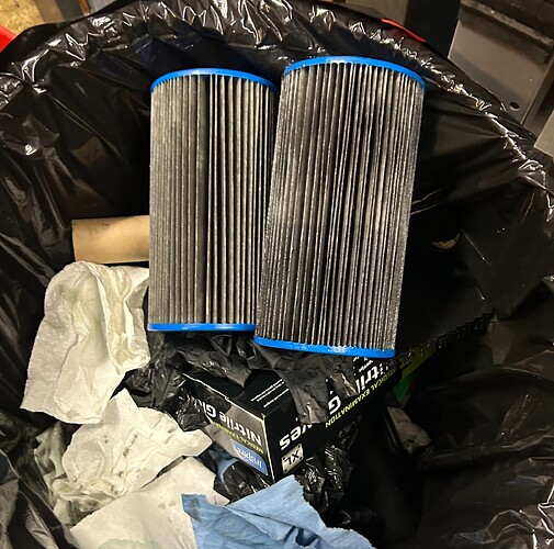

Using your pool filter idea, we found some on Amazon last week,and started running the same simple cylinder type as you.
One in the IPA and one in the SG.
after 30 minutes in each.
Filter on left is IPA, filter on right is SimpleGreen.
This will help us significantly in the clean up of IPA during recycling, as it greatly lowers the amount of sludge and partially hardened resin during the process.
The fact that these cylinders can go in vertically is very good - the impeller actually sucks liquid thru the center, causing it to be captured in a really direct way.
