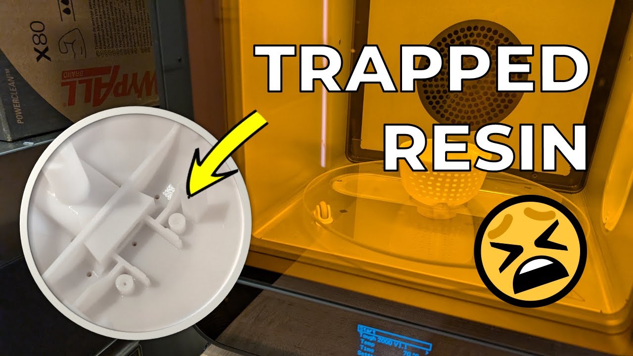

I wanted to share a new trick that we recently learned for ensuring small, deep, blind holes came out clean from the wash every time.
We were printing 200 of these enclosure parts for a client and these small standoffs for self threading screws were always coming out of the wash with resin still in it.
Simply by using an allen key to force the resin out pre-wash, this ensured that IPA would make its way into the holes. My guess is that surface tension and viscosity play a role here in preventing IPA from cleaning the hole properly if there is trapped resin inside.

Getting resin out of thin deep holes can always be a struggle, this is a cool trick that will definitely help people with their projects.
I sometimes use a dental pick or wax carving set to do similar things on my parts, just like you I am not a fan of using compressed air as that just flings resin everywhere. Some people have grabbed cardboard boxes and blown off parts in there, in the dental space some people have tables with a hole in the middle and a garbage bin below that, which they use for cleaning with compressed air.
What I’ve done a couple times is adding a small hole into long standoffs that goes sideways and makes the screw hole into a throughhole (without going to the outside of the part), using some of the stiffer resins be careful with that technique as it can influence the integrity of the standoff.

As soon as I posted this video, a friend who runs a larger service bureau (3DS + Stratasys machines) literally told me to try using dental tools :sweat_smile: I’m going to order some and see how their fare. I kind of like the simplicity of cleaning an allen key versus dental disposables, but we’ll see how it shakes out.
Agree on modifying to make parts through holes…unfortunately I don’t always own the design portion of parts we print :cry:

Even if you don’t own the design you could add the small holes (to allow IPA in and out) in Preform if the design owner approves?
I like to remove as many manual post processing functions as possible by “design for additive” mods. As they can be missed or not done properly causing quality issues.
Great video BTW :+1:
Yeah, actually thinking about this one - I probably could very well add a side hole to these standoffs, especially since these are internal and not visible. I might actually do this on the next run of parts.
I can’t always make changes like this, but I think it’s totally appropriate for these ones :raising_hands:

That’s a really practical tip! Using an Allen key to pre-clear the resin makes a lot of sense—surface tension can definitely trap liquid in tiny cavities. I might experiment with this on some of my deep blind holes too. Have you noticed any risk of scratching or damaging delicate features when forcing the resin out, or does it generally work fine for most small parts?
I haven’t noticed any issues. Just pick an appropriate sized tool :sweat_smile:

@leonhart88 which resin made the parts in this video? Always good to have details like that in the description even if you don’t mention them in the video, like people put their camera gear etc! Sorry if you already did - I watched the video when it came out and am on a low rate connection where I can’t load YT to double check. It’s always helpful to see real parts made on these printers and know what materials are viable for them.
Oh weird, I must have forgot to mention that (I shot the video a while back and only got to editing it now, so things were forgotten :sweat_smile:)
This was White V5. Cleaning resin out of holes is harder for more viscous resins like Tough 2K, so this trick will come in handy even more so for those.
