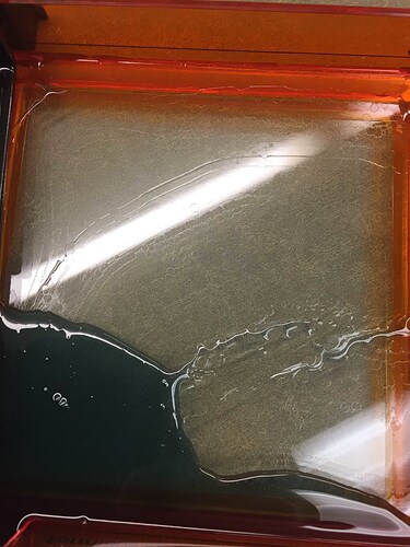

Randy, I pulled the tank, nothing in it that I could see. I know what the cured stuff on the bottom looks like, my last clear tank had some cured resin on it. Drained it, cleaned it, its spic and span … running another test print now.

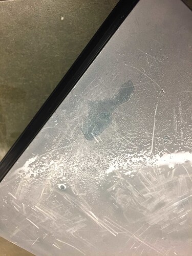

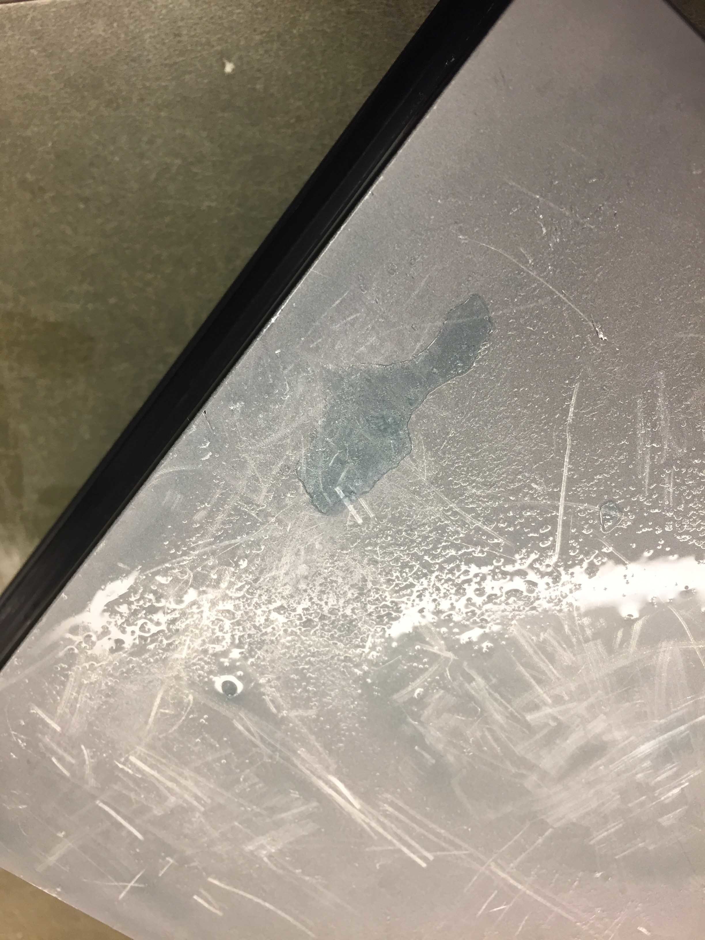

Here’s the small amount of cured resin that was on the platform, it didn’t feel totally cured. scraped off very easily.
That’s it after a 3 hour print? Something doesn’t make sense.
Looks like either the resin is bad or your laser is bad. There ought to be a ton of cured resin in the tank given your description of the print failure. The only explanation I can think of is that the resin won’t cure or the laser isn’t hot enough to cure it…
if you have some clear left clean or use an alternate tank and start to print anything. See if you can see the laser working and if a print works. If so then the resin might be bad.
