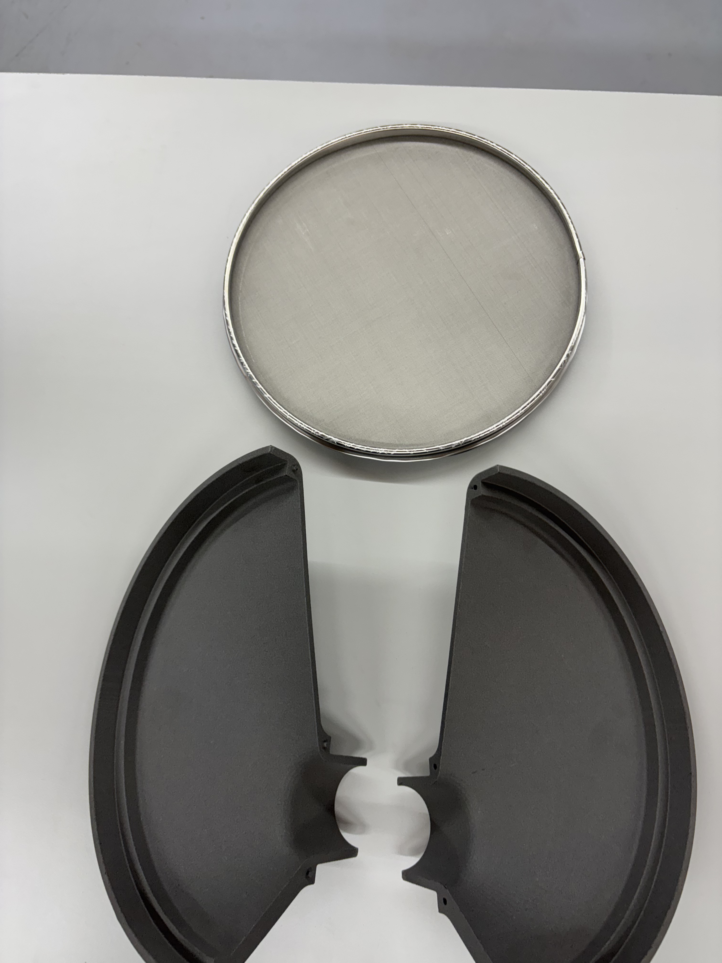

Yep.. I checked out your funnel.step, got any pictures of it in the hole? I’m about to cut up an old Sift screen to pre filter these trash bags and was thinking about your funnel with a screen as being perfect. I’ve now had two fails with plastic trash from these dumb bags.

I’m thinking a more corse screen will do the trick. I was really excited to try this idea.. still want my jugs back.

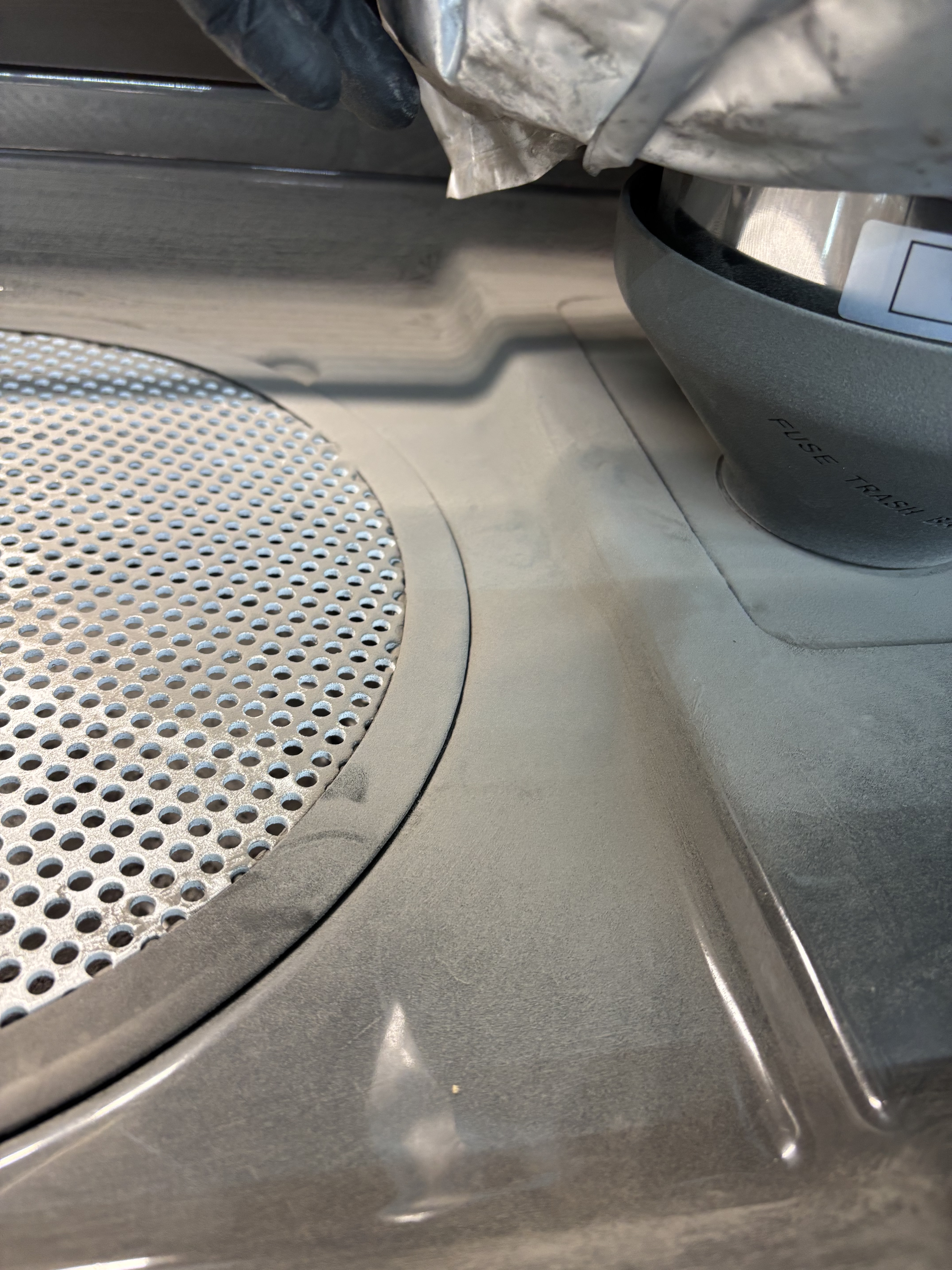

HAHAHA… I’m gonna give the sift funnel project another go at it soon. I got the rest of that bag to put in there. I’ll just slow it down

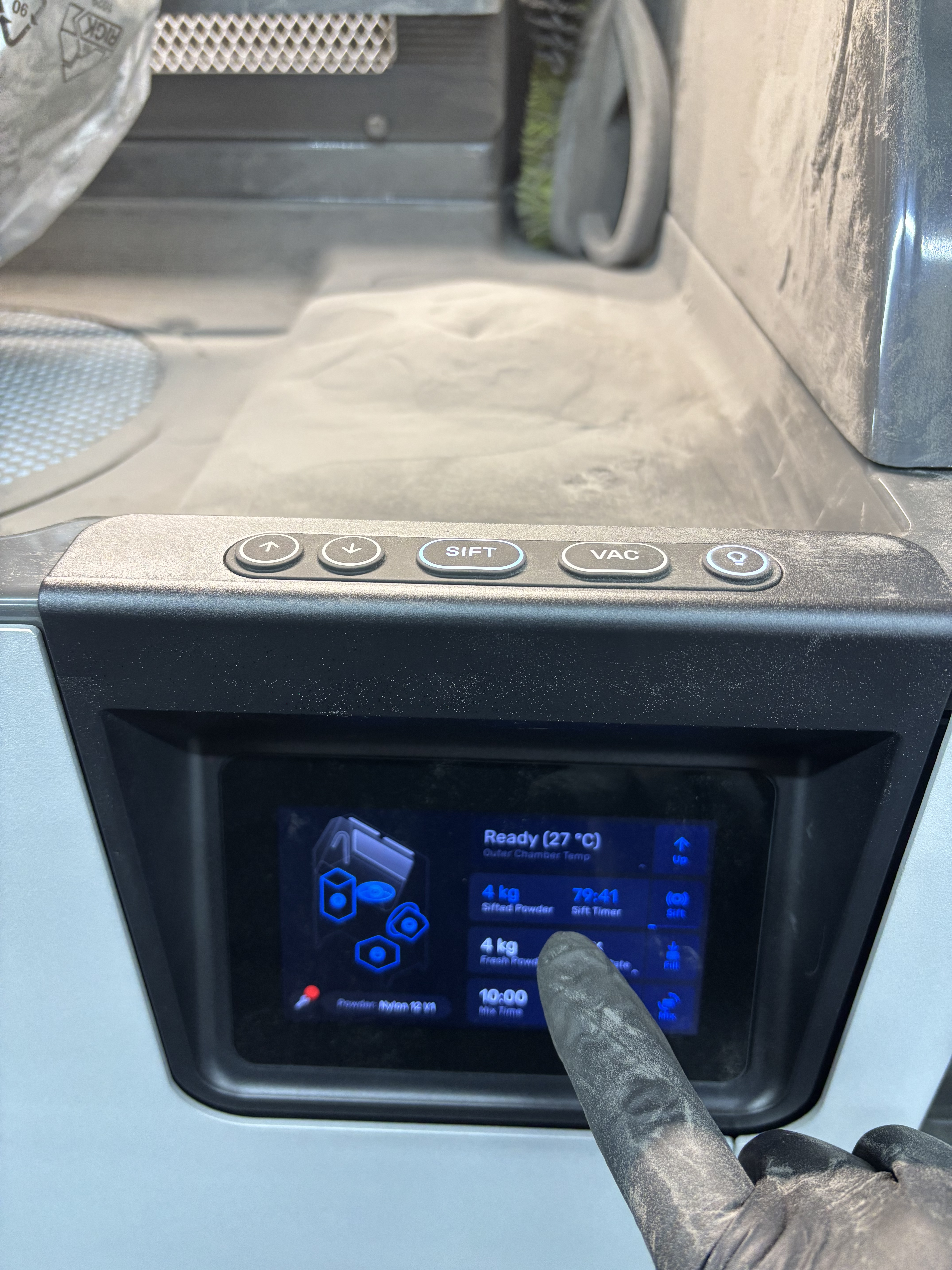

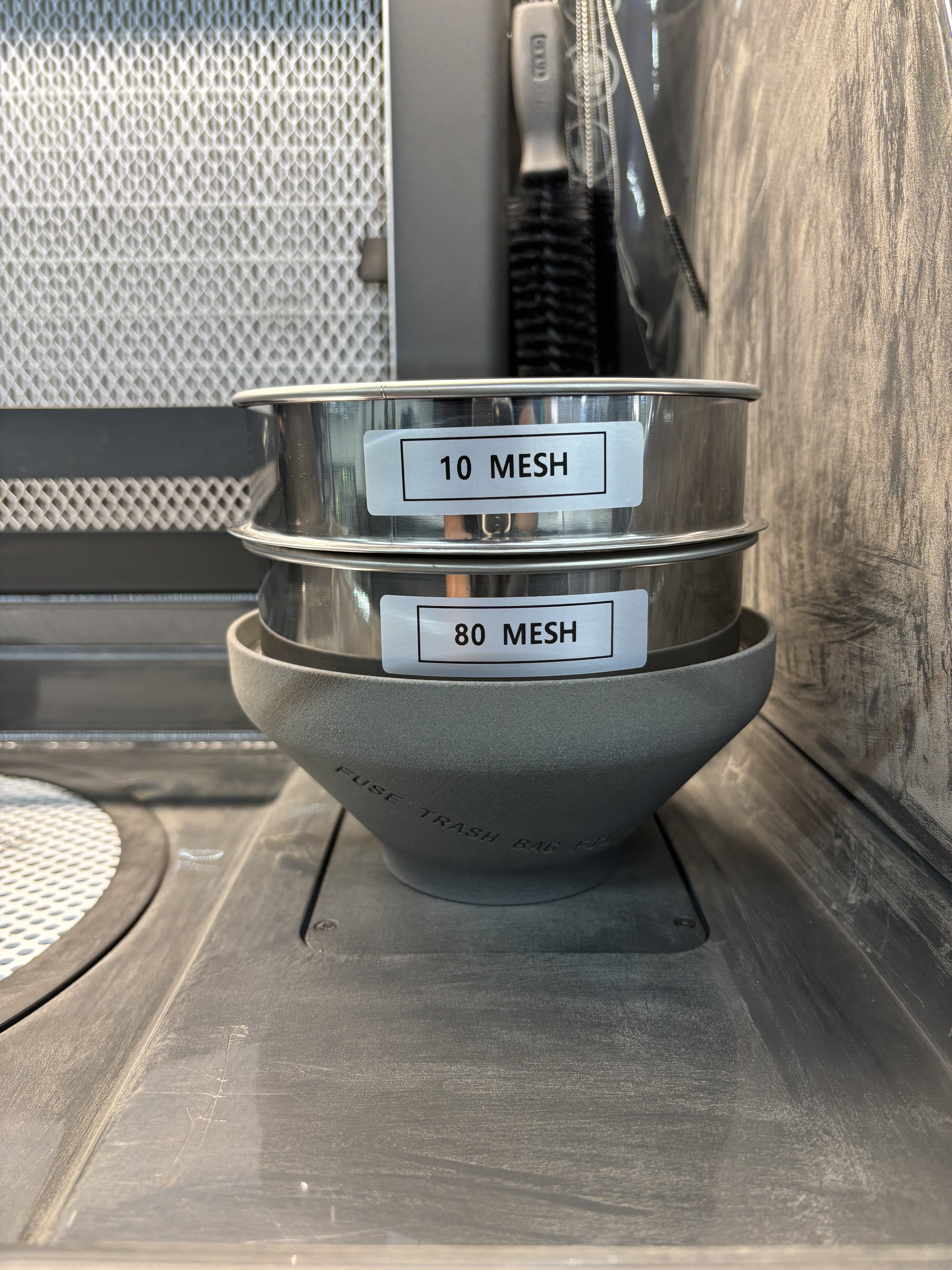

Round 2… Still not happy, still making a mess. Fresh powder sensor was slow, so I overflowed.. more mess. Bright side, it’s filtered.. Slow and steady with the 80 mesh, needs a 40 mesh to balance out the drop. Here is the link to the amazon parts. 3 Pcs Lab Sieves,6 Inch Diameter Test Sifter 10Mesh(2.19mm)、80Mesh(0.217mm)and 200 Mesh(0.077mm): Amazon.com: Industrial & Scientific
I will post up the STL in a min.

FuseFilterFunnel002.stl (1.9 MB)
