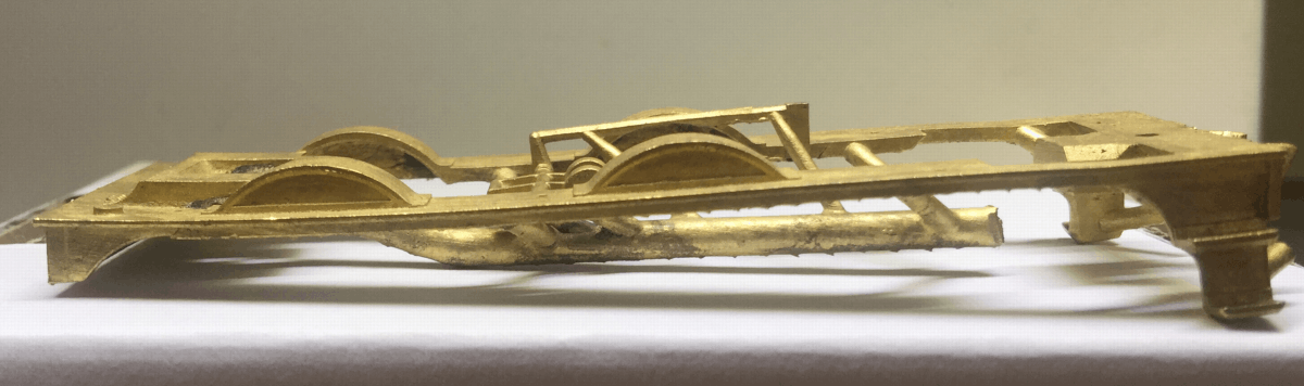

Just cast with my best results so far. I added another 25 degress f to my top temp. Now at 1375F for 4 hours. I flipped the flask at approx 700 F (after wax spruebase was out and pointed up. Had only 1 very minor flaw which was easilly repaired. Thanks you so much for all your help. Will keep on trying until I am at 100%! I would say this last cast was 98% successul.

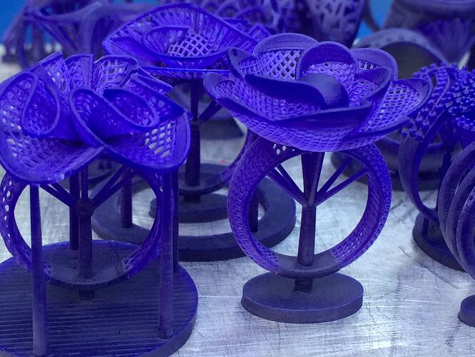

Adhesions test (low res and horizontal arrangement) make by our friend. Rings and bracelets by form2 and BC, printed without adhesions problems :wink: over this size…
If you want you can also print without base using our primer. Basically is an adhesion promoter that replace the base letting you waste less resin.

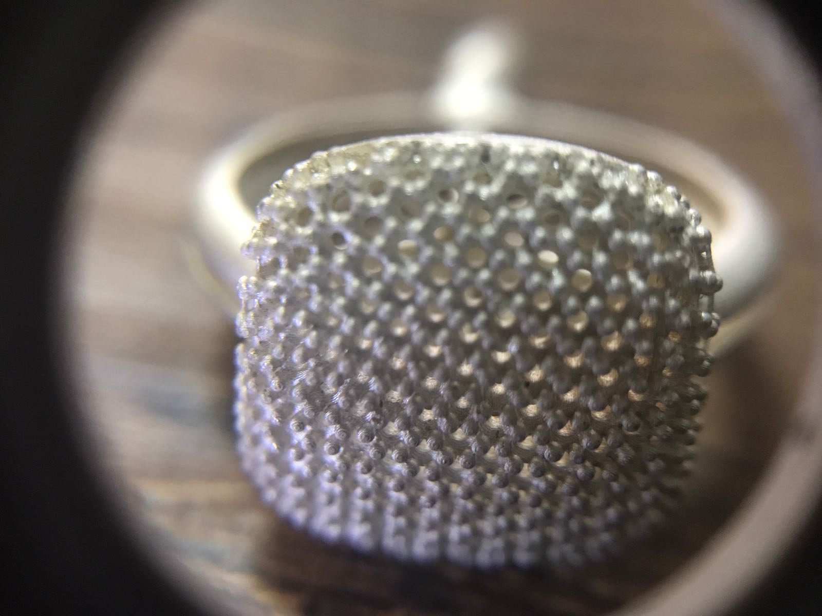

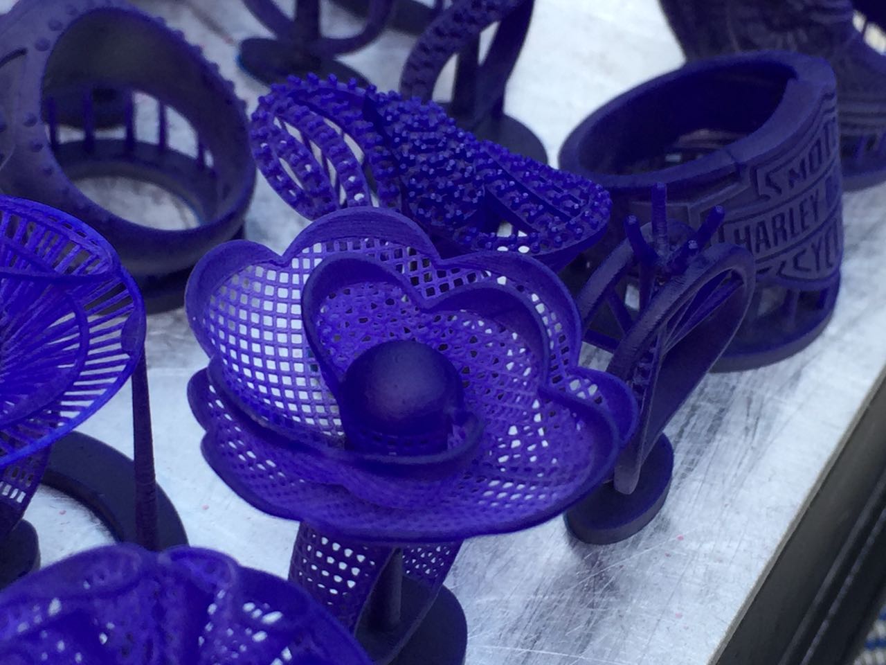

with LS you can get unbelievable results. Some prints are impossibles to made with other resins. Please see the accuracy of filigree. If you want you can see some works of our customers on Bluecast Facebook page.

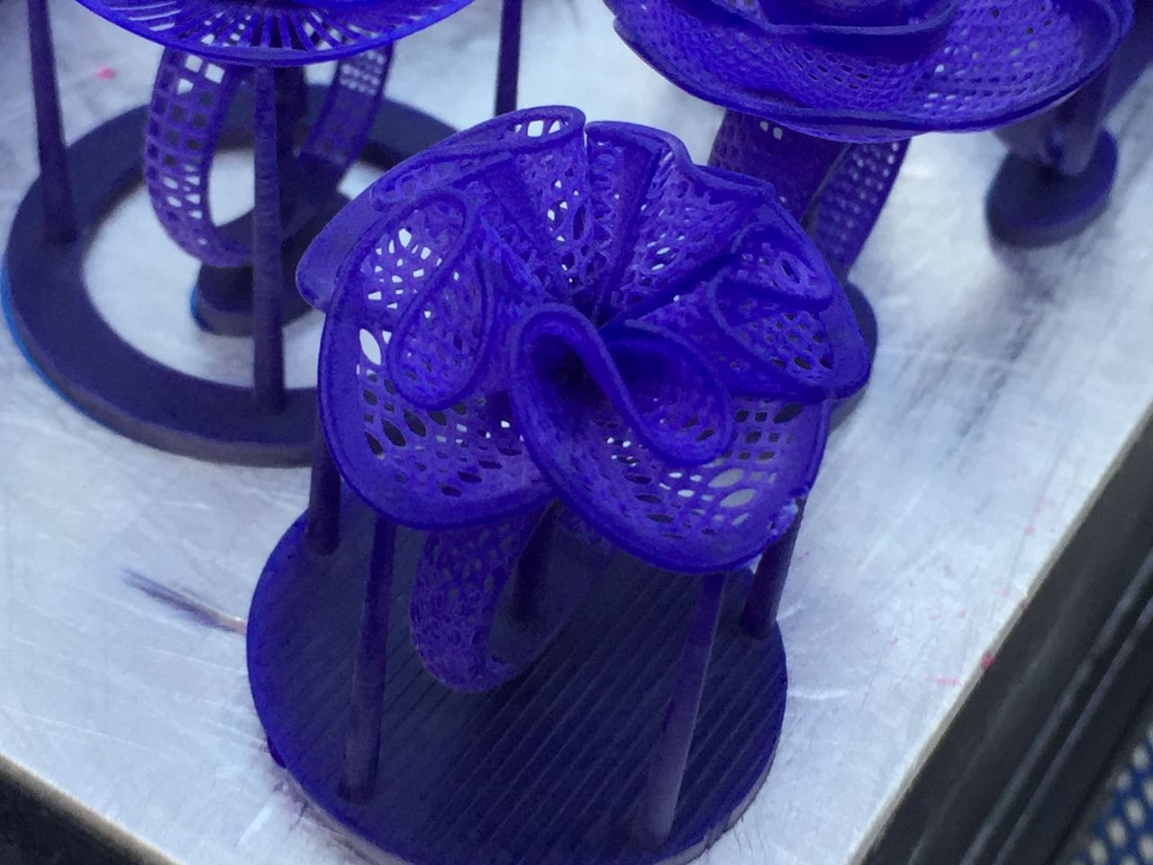

Brothers…if there was a shrinkage it would be impossible to print and cast this bracelet without making it look like a pudding :slight_smile:
