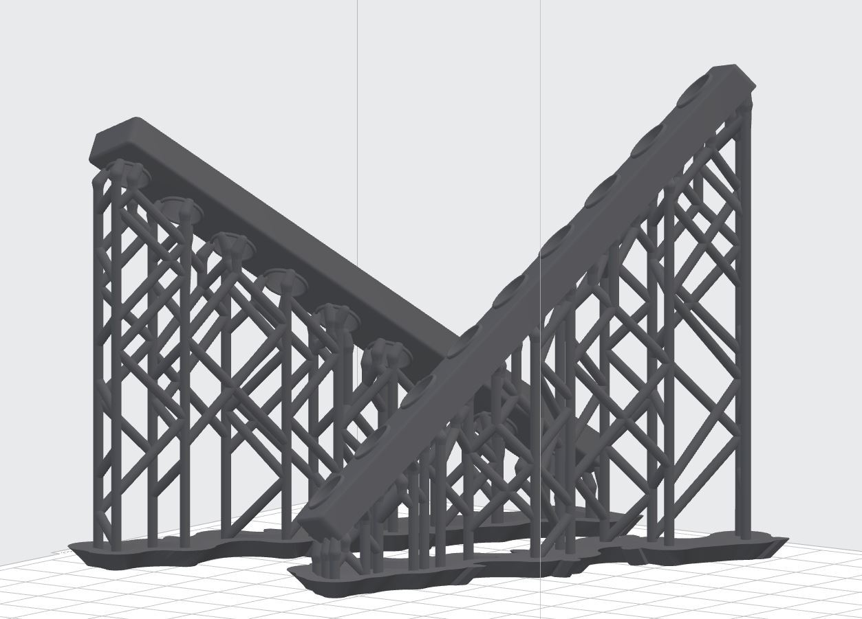

So what density and point size is a good starting point? I have added a couple pics of the parts.
Your pieces look fairly well supported for their size/weight. They probably would print just fine. If it were me I probably would add a few more supports in spots such as these (see image below). But I’m overly cautious…like I said before it probably will print just fine.
I submitted with the standard 1mm density and 2.2mm point size for the first try. Thanks for the feedback!

It looks like you have thin, raised areas around the holes on what appears to be the face of your model…IMO, you will not be pleased with these areas once you have cut off the supports. As I noted earlier, keep your supports in areas not seen in the finished product, if possible.

thanks for all the insight. The parts were “successfully” printed with 2.2mm but like everyone said, I wont be happy with the look after removal. I didn’t think to freeze or to remove the supports before curing…will try next time.
