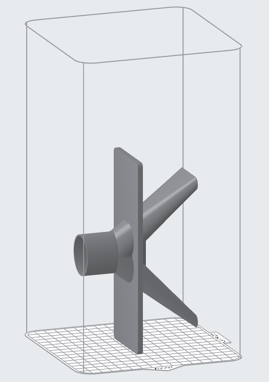

Vacuum cleaning nozzle
The vacuum cleaning nozzle is designed for use when cleaning powder out of a Fuse 1 generation printer and cleaning the print enclosure on Fuse 1 generation printers.
STL
Fuse 1 generation vacuum nozzle in PreForm
Vacuum cleaning attachment for hopper
The vacuum cleaning attachments are designed for use when cleaning powder out of a Fuse 1 generation printer.
V1 is compatible with Fuse 1 and is designed to remove powder through the hopper.
V1 STL
Fuse 1 generation vacuum attachment V1 in PreForm
V2 is compatible with Fuse 1 and Fuse 1+ 30W and is designed to remove powder through the inside of the printer.
V2 STL
Fuse 1 generation vacuum attachment V2 in PreForm
