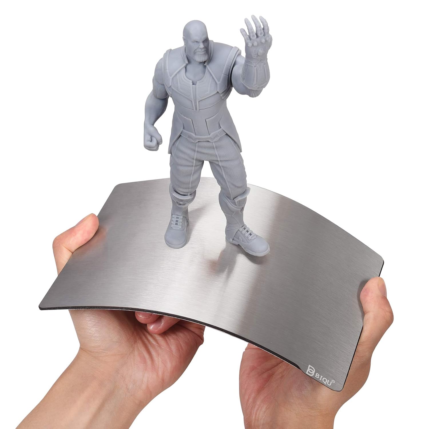

I use a flexible build plate. The things attach to the print bed magnetically, then when the print is done, you take the plate off and flex it. The print pops right off.
I use this on my Anycubic printers, but they should be available in square size for the Form printers as well
Don’t know about yours but my Formlabs build plates are aluminum (non-magnetic). Clever idea though.
The standard build plate for the Anycubic is aluminum as well. These flex plates come with a self adhesive magnetic layer/pad (similar to the type you find on refrigerator magnets, but a lot stronger), which you stick to the build plate. You can see the magnetic pad in the image below.
The steel flex plate sticks to that. After the print is done, you pop the steel plate off the magnetic pad using the little tabs you see in the photo, and flex it.
I use these on both my small Mono and the larger Mono X, which has a 192x120mm surface, and they work great. The only thing you need to do, is account for the additional thickness of the magnetic pad (~1/8" worth). You can do that by adjusting the print bed height with the fine tuning function.
