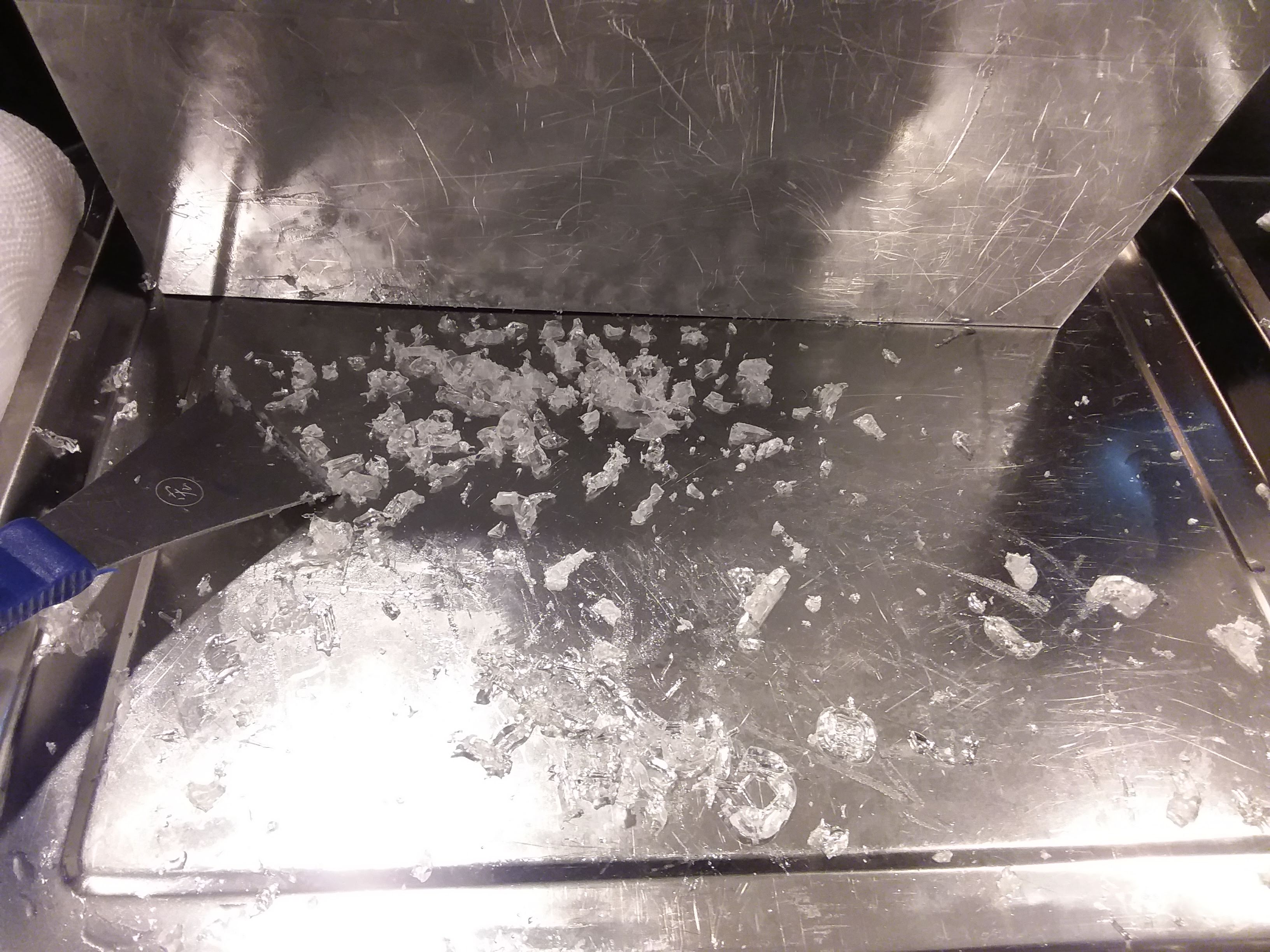

With black, clear, grey, Tough 2000 resin, most of the time, I have problems to remove the parts from the Build Plate. At least, the parts are well printed… Never seen problems like this with the Form 2.
Any Idea? Because I don’t have solution and I’m tired of this.

Very good! Absolutely. The best idea. When the parts remove easily, with no residue and you don’t have to change resin. If it’s possible for me of course. But for me, 75% of the time it’s like the pictures showned…

Hello all Form 3L guys. Just an update here. FL kindly offered me a new build platform, after all the problems encountered during this year. I have to say that it resolved completely the problem of parts stuck on the build platform. When I look the both surface finish, I clearly saw a difference. So, after 4 successfull prints, I remove all the parts so easily. No more “glass like” resin parts, for now. Strange, but I am really happy now.
This was all about the surface finish updated by FL. You can see a “Milled” versus a “Sandblasted” surface on the pictures.
