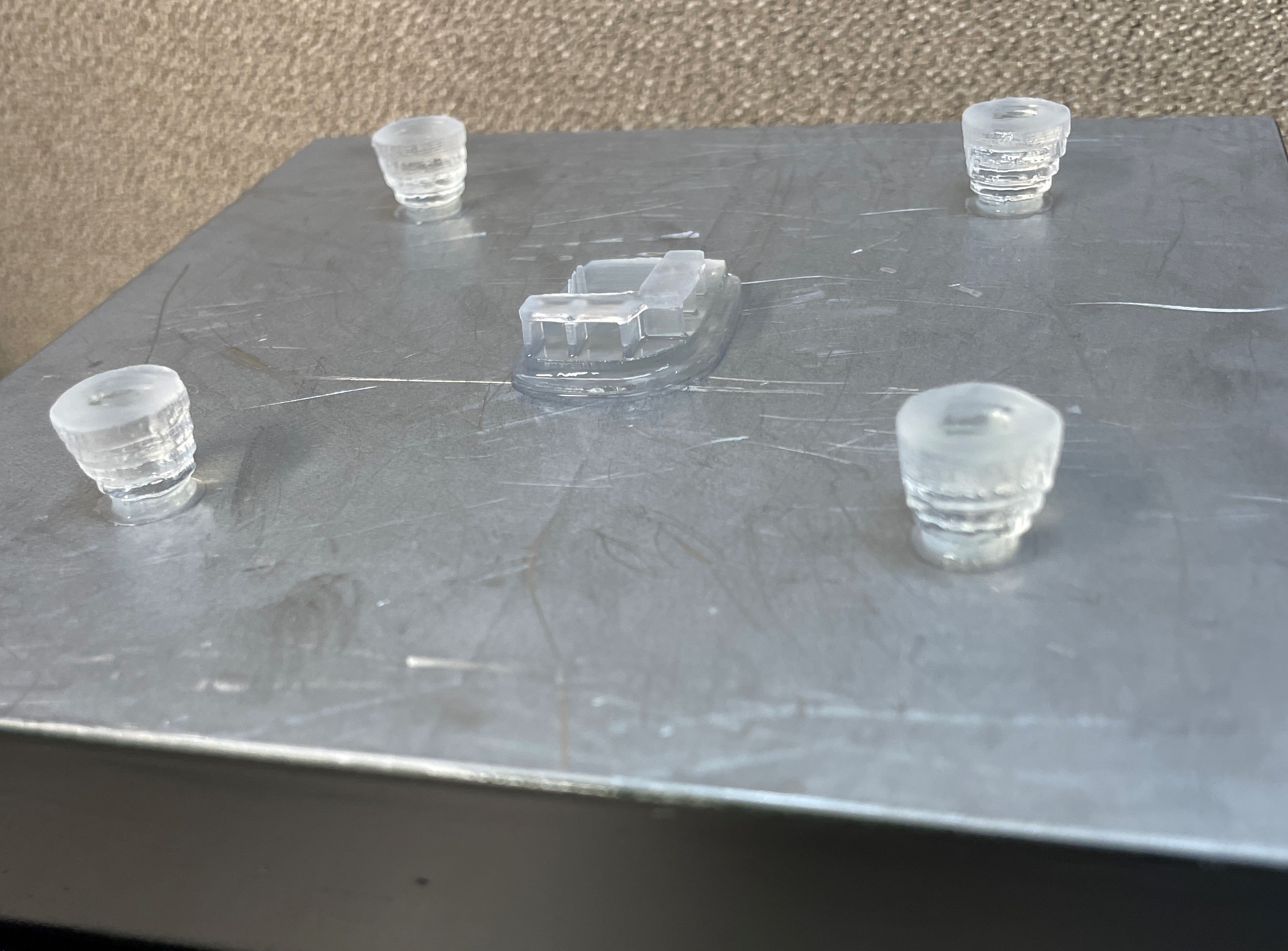

Hi, I have the same issue and after cleaning the optical window and changing a new tray, the test printing is shown as attachment. Could anyone suggest what should I do next to fix the issue?
Thank you very much for any help.
You need to clean the mirrors inside the printer next. Though, the Form2 tests laser power at the start of each print and that data is reported back to Formlabs. So you could ask them to check your printer to let you know if the laser is having problems before you go to the effort to taking the machine apart to clean the insides. If the laser is failing, no amount of cleaning will help.
I cleaned the lens, glass, and mirror today and it did not help one bit. I really don’t understand why the print quality all of a sudden can drop so much after perfect runs. This current printer is a replacement (reconditioned) unit sent by Formlab after my relative new Formlab2 had the exact same problem prior to the expiration of the one-year warranty.
I also used new resin and the tray is almost new so I don’t think they are the cause of my problem. Maybe the laser power can drop drastically and maybe I can call Formlab to let them check it.
