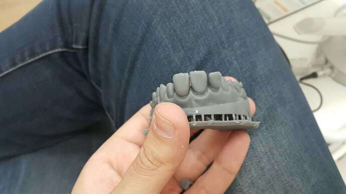

We are Pro-dent Dental Laboratory from Dubai. Just a question regarding the difference between castable and non castable material. As we pressed veneer, printed of not castable material and it works. Why should we pay more for the castable material than? )

We printed the veneers with castable and non castable materials and the fit is not good.
On the design I removed the drill compensation that I am usually using for wax milling and kept same cement gap as for milling. (10 micron) but both versions doesn’t fit on the model.
Can you suggest what should be the settings for the cement gap?
