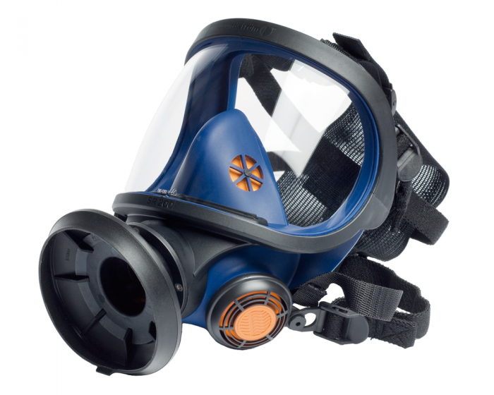

Huh? I was able to pick up a SR100 Pro Pack Kit that comes with the respirator and a bunch of filters for $58. It’s gone up in price a little since I got mine, but here is a link.
Heck, you can even pick up a full face mask kit with filters etc. for ~$230
