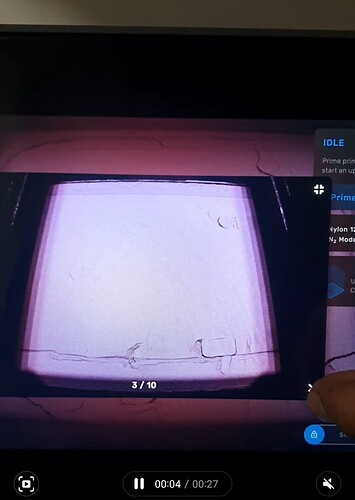

We have been using the Formlabs Fuse 1+ 30W for a couple of months. Printing Nylon PA12 was not a problem. The prints were successful, some minor defects in the surface finish were seen but overall the prints were good.
We are a service provider in India and our goal was to target a less competitive market, which is Nylon PA 12 GF. There arent many service providers in Pune, India, that provide PA12 GF. Our experience of printing with this material in the formlabs printer has been a very challenging and costly.
We have had a failure rate of 70% so far. We have nitrogen supply to the printer, we are using a refresh rate of 50%.
We have uploaded all logs on formlabs support. We updated the software, we have made sure to use 100% virgin powder, we also vacuumed the whole printer. However, we are still facing this issue.
I have attached photos to show the failure. Any recommendations or suggestions would be appreciated.

Looking at this… we had the same exact issue for over a year while troubleshooting with multiple Formlabs reps online, over the phone, via hundreds of emails and someone onsite…in which none of that resolved this.
The eventual fix, that we figured out on our own, was bumping up to a 70% refresh rate which eliminated everything you see in these photos.
Sucks to throw all that powder you can’t recycle in the trash… but that nearly eliminated all of the powder related issues like this one.
In fact we can tell when the printer will be successful by watching the powder build up, on the camera, along the back wall/roller path. If that powder looks fine the print will be good. If that powder has any clumps or a crumble look to it… it will fail.
I can tell by looking at your photos that it has that clumpy look to it. This will be an ultra fine stack of powder above a 70% refresh.

Are you running GF with or without nitrogen? We have been suggested to run GF without nitrogen to see if the build prints successfully.
Hi,
Thanks for your comment. We have been in contact with formlabs for the past few weeks. We just ran a print yesterday with no Nitrogen and a 70% refresh rate. The print was successful, we are yet to remove the parts to check for wrapping or failure but at least the print was completed. We did try 70% refresh rate earlier and still had a print failure. I am not sure how not using nitrogen has helped but that is the only thing that has changed and we have had success.
We vacuumed the whole bed and the doser a couple of times, to make sure there isn’t any debris from the previous failure. We didn’t consider the powder heating up from previous prints. Definitely a useful tip.
