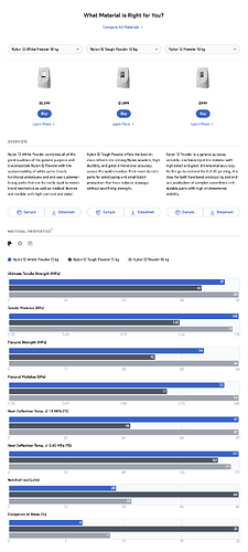

Regarding the Nylon 12 White, here is a comparison between Nylon 12 White, Nylon 12 Tough, and regular Nylon 12:
