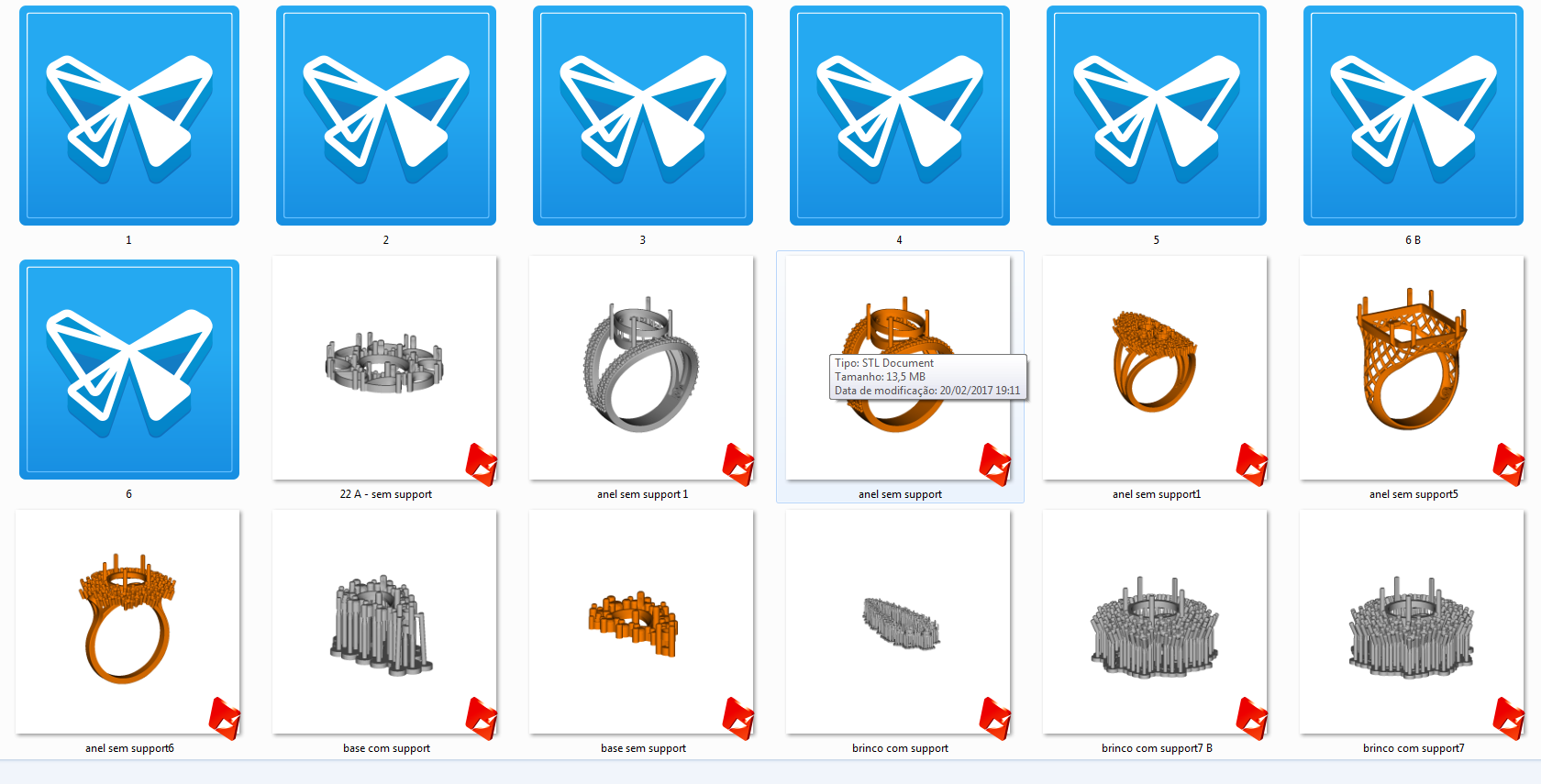

I updated my preform today to 2.11 and I noticed that it isn’t opening files with accents (ç, á, ã, …), also it doesn’t work if the file path to the file have any accent. This is happening all files, FORM or STL.
