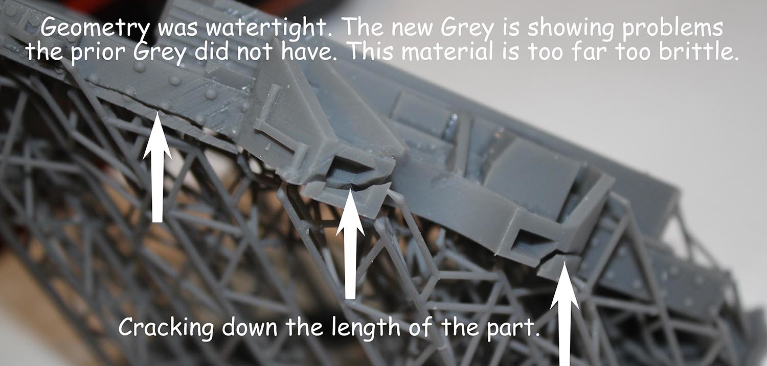

Just got some horrific cracking along a part. Seems to me that the new Grey is just too brittle. This part was completely watertight so there was no need for the Geometry to crack. Also its a pretty big part so I don’t think wall thickness has too much to do with it.
Any ideas on the new Grey?

Your experience with Grey V3 doesn’t look to be typical and we’ll want to make sure there isn’t something functioning incorrectly with your printer. Under-supported geometry can sometimes cause cracks like this but they’re typically more linear. I’ve reached out to our support team and one of our members will be in touch over email to help troubleshoot.

I’ve seen cracks like this on a few parts (various "standard resins… white black gray), but very uncommon, and not reproducible). We’re talking like 3-4 out of +400 prints. I’ve rerun the same parts (same file) and it’s been fine. I’ve attributed it to, simply, just one of those things that happens, sometimes. I’d run it again.
Make sure your resin is mixed enough before printing, it’s important to use the scraper to stir the resin in the tray and shake the resin cartridge before printing again if you aren’t printing continually.
