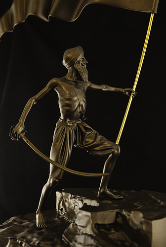

A statue produced for a client. Overall height 500mm, figure height 200mm. Printed on a form2 in grey. I hope you like it.
www.formwurx.co.uk
Very cool…I really like the way the flag turned out!

Awesome! Could you post a screenshot of the positioning with supports? I can’t see any missing details from support marks, wow!
Thanks Phillip
The main reason you can’t see supports is I minimised their positions on the print by printing in sections with most of the supports on the sections that would be hidden when the components were joined. I also made sure there were no supports on areas containing fine detail - only flat areas. I’ll post some screen shots tomorrow.
