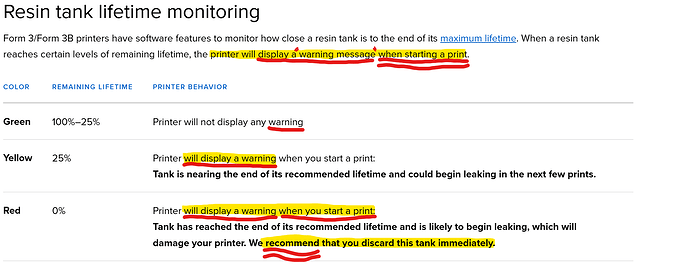

AND on review, there *is no verbiage in any guide published by Formlabs *that actually comes out and tells you that expired tanks will cause your Form 3+ to refuse to print.

I wonder if this is specific to Tough 2000. We’ve had tanks for Grey Pro that were printing just fine long after they “expired”, and did indeed only give a bypassable warning. The estimated lifetime for tanks definitely feels more like a strong suggestion than a set rule in our experience (only if you very diligently and frequently check the condition of the tanks tho. Don’t just let them sit there indefinitely!)
Ive never had the machine refuse to print with an expired resin Tank I have some well over and it just gives me a warning and I Ignore it and continue ptinting.

We’re sorry to hear about the issue caused by the tank expiration error.
Like others have commented, this error is designed to be a simple warning message that can be skipped, allowing you to continue printing until the tank is eventually replaced. If the error message you’re seeing is not skippable, could you please provide a photo of it? This will allow us to investigate the issue further.
