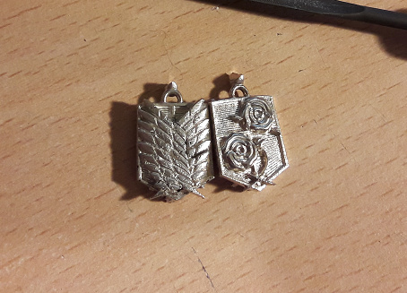

While I was typing the response above, I actually had a couple of pieces going through this process (a friend has 2 daughters who are really into the Japanese anime ‘Attack on Titan’. He asked me to design and cast them some pendants):
So this is from 20 minutes in the hot pickle ultrasonic, and 40 minutes in the pin polisher with no human intervention. All the investment is gone, there’s a dull shine, and they’re ready to have the sprues filed off the backs and jump hoops. The left one is exhibiting some of the porosity you sometimes get with the castable resin, but it’s pretty shallow, so will polish off.
Did you print these on a Formlabs printer?
Yep. Done on my form 1+ in castable resin.
