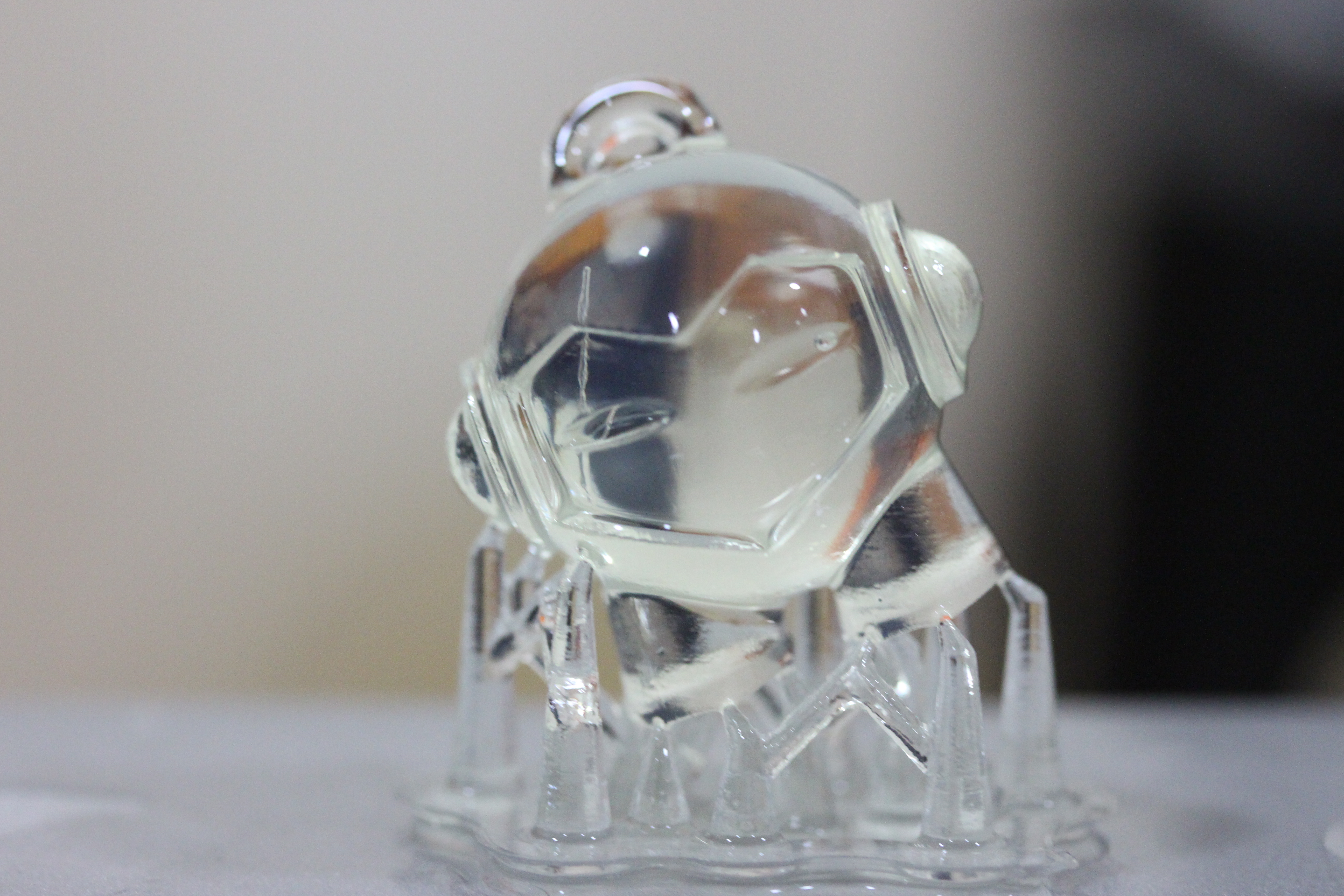

Sorry for the late reply. I have attached some photos showing the “streak” in Marvin’s right eye (left of photo) and I also added a .form file. I see a small white strand in the big mirror below the glass of my form 2. Is it what’s causing this problem?
Thanks for the help!
Marvin.form (1.3 MB)
Hm - the print result indicates some type of optical obstruction, and the strand that you mentioned is certainly suspect. Could you send these photos, as well as images of the strand on the mirror, to our customer care team (upload here) so that we can look into your prints? Thanks, @aad345!
I have had similar problems in some of my prints.
The culprit turned out to be a hair stuck to the bottom of my resin tank.
I had been inspecting the mirrors etc but not the tank…
The resin tanks seem to take on a static charge and attract all kinds of dust, lint and hair.
I now inspect and clean the bottom of each tank with a microfiber cloth and/or compressed air.
Good Luck
