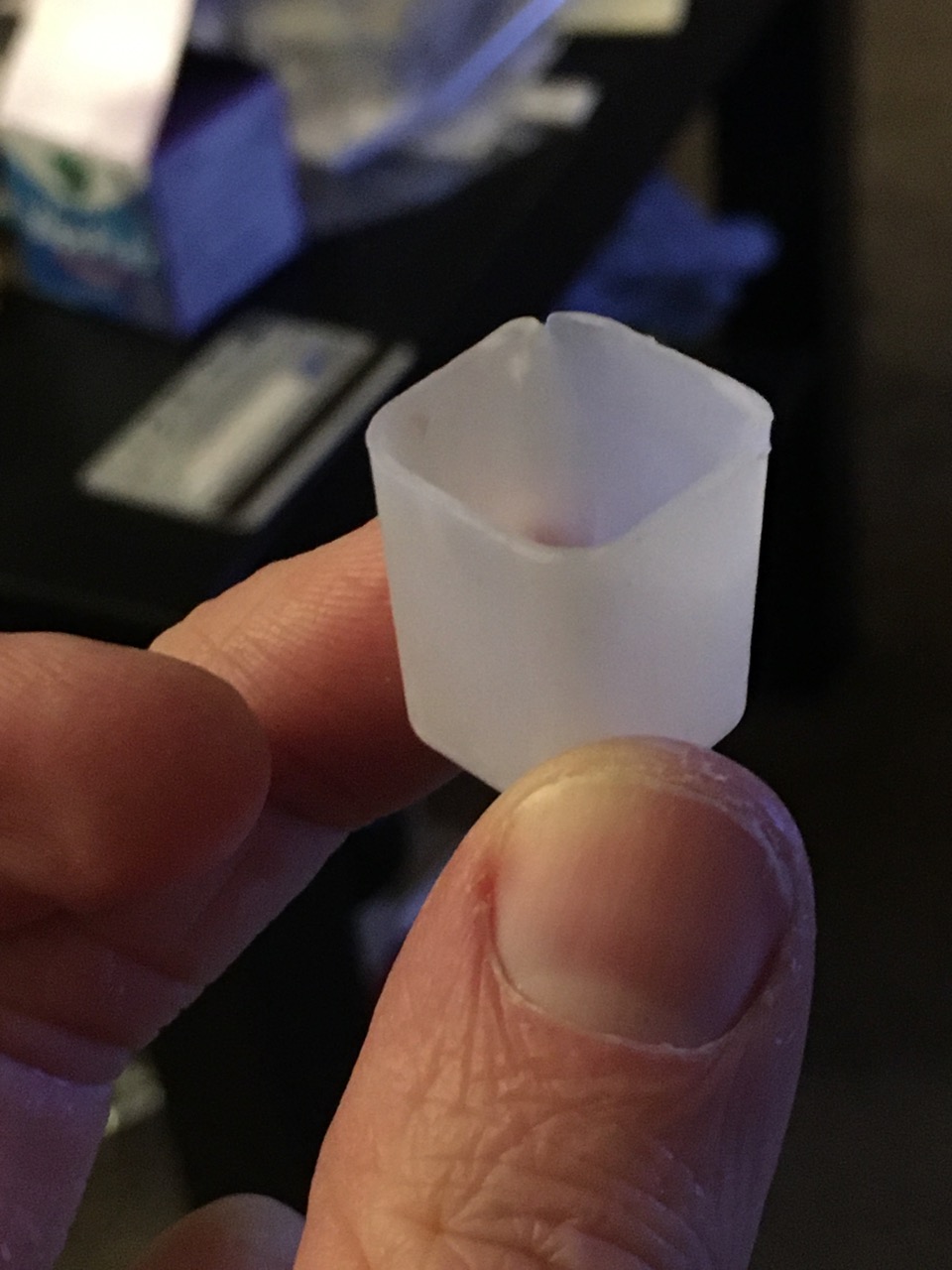

To learn and become more familiar with the process, I decided to try making a simple cup-shaped part. I was pleasantly surprised at the ability to mold deep thin walls (I believe the walls are 750um thick in this part) and I didnāt have too much trouble getting this part to form successfully. The biggest challenge was de-molding. Even with 5 degree draft, it was difficult to remove this part from the core. The imperfections you see on the lip of the cup are due to me using a knife to pry it off the core. This was done with PP in a High Temp V2 molding die. Iāve also done the same part in HIPS with a White V4 die.
