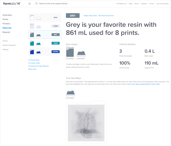

Here’s a bit more information about what signs to look for before replacing a Formlabs resin tank. You’ll also notice that today’s update to Dashboard includes resin tank “heat maps” for network connected Form 2 prints.
Here’s an example of a heat map for a resin tank printing with grey resin:
Wow, I didn’t know it existed. Nice dashboard update!!
