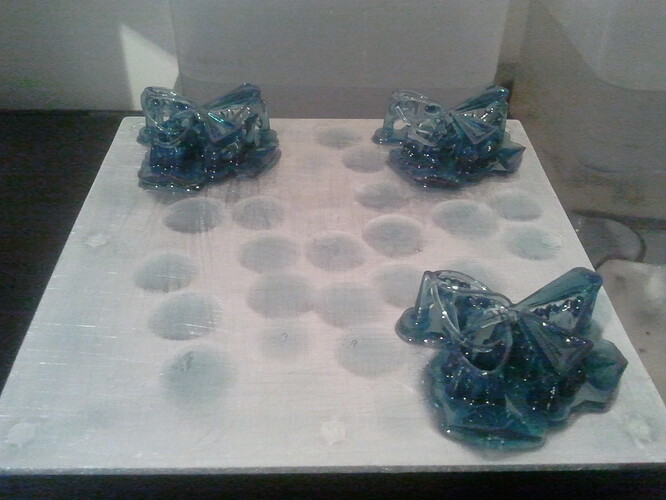

Well my ticket is being looked at (can’t fault the service help guys and girls). Here’s the formlabs test print in both tough and regular resin. I was asked to print in regular as the tough was showing signs of issues in the optical path but the regular came out perfectly and I only just cleaned the mirrors a week or so ago when I moved into my new print lab.
The tough resin print left two of the butterflies in the tank and only 2 were properly attached, the third was attached but only by around 50% of the base. Getting those off that were attached was a nightmare. I ended up having to use a hammer and chisel as all the tabs broke off and the scraper was all but useless.
I really hope I can find out what the issue is with my setup as a good few requests that I’ve had could have used the tough resin.

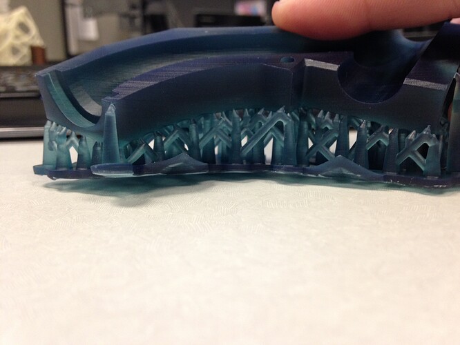

Interesting because all of a sudden I have been having multiple failures and it is because part of the support base is not adhering to the build platform…
Weird part is that the base platform is the same thickness across so it is almost like the layers were built and compensated along the way.
Tom
The low angle you are printing at presents a lot of peeling surface area and load. Have you tried printing at a steeper angle to try to reduce the peel area and load?
