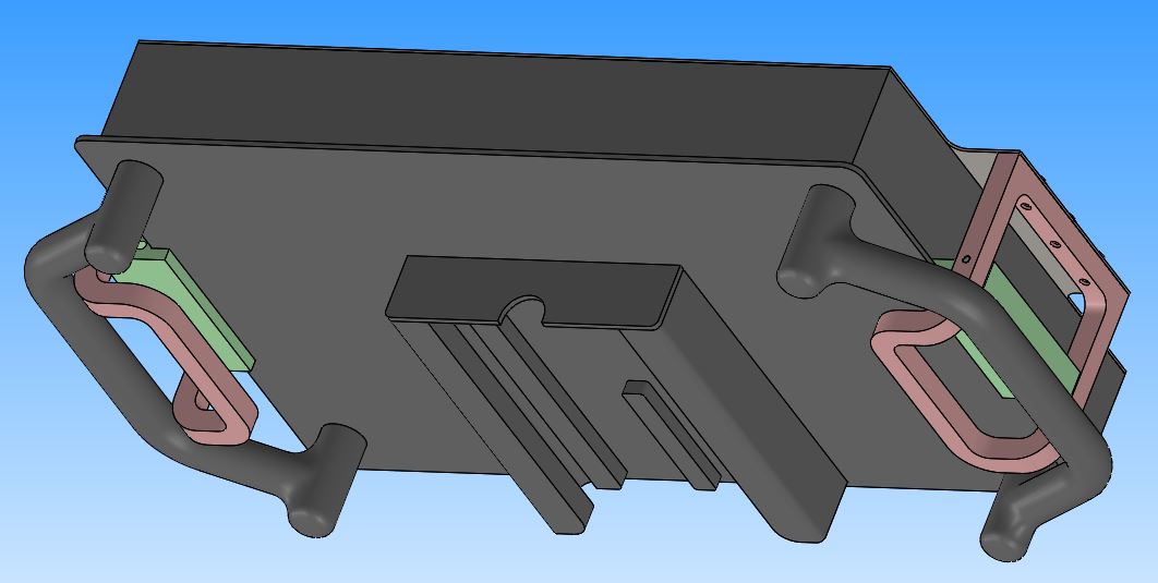

Sorry I’m a little late to the party here but I don’t check the forum often enough. I started doodling a concept awhile ago for our 3BL but never actually made one.
